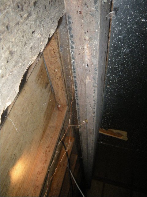

After more than 1000 inspections, I’ve come across my first wood foundation today. The mud sill appeared to be treated wood, and relatively new. The sill supported a wood crawl space wall structure similar to a cripple wall. Large posts at the corners support double-girders.
Any issues to be aware of? Any disadvantages to this construction method?

How were the wood corner support posts supported (footing-wise)?
No resemblance to wood basement walls we have around here. Always 2x6 (sometimes 2x8) 12" on center. How far underground is the wood? Does it have exterior plastic waterproofing?
I didn’t actually inspect this house. I viewed it for 5 minutes as a favor for someone semi-interested in the property. I immediately recognized that I had never seen anything like it and took some photos. The piers appeared to be creosote. The portions between the piers, I’ll call them a curtain wall, were wood. The bottom sill was treated, but was in direct contact with soil. I think the curtain wall only serves to keep possums out from under the house.
I don’t know how deep the piers went and don’t know anything about the footings.
I do know that all wood rots, even creosote, over time. I’d be wary of this building technique if it were me. I want a home that will last several generations…not one that will require new posts in 75 years or so. House was built mid-70s.

Is there no stem? Just beams laid accross the soil? I could think of many reasons this would not be right…but then again I am in CA.
That’s what I saw.

Wood foundations don’t need footings…their bottom plates serve as footings. They are typically bulit as normal stud walls, and the wood used is required to be pressure-treated far beyond the normal levels, and is usually only available by special order. The walls are installed on a gravel base, and the detail between the wood walls and the concrete floor slab is critical.
I’ve never used one, but I would if there wrre enough reasons to do so, such as a very steep property where getting concrete of blocks to the building site would be difficult.
I talked to another inspector who is also a licensed general contractor. He said in about 5,000 inspections in the Carolinas, he’s seen about a dozen of these structures. He emphasized that he life expectancy of treated wood in direct ground contact would be about 20 years. The home is over 30 years old, and the curtain wall between the piers has already been replaced.
In my conversation with the client this a.m., I informed her of the issues with wood and that future structural repairs can be anticipated at some point. “Have you ever seen those guys who work for the telephone company replacing telephone poles,” I asked? “They do that because the poles have rotted to the point that they are no longer structurally sound. That will happen with this house too.”
