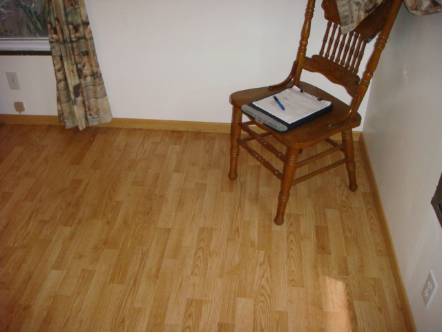

Larry, Just curious to let h/o’s know how much they got ripped off by the elect. here’s the room. probably 25 feet along wall between the two.
Is any point on the wall more than 6 ft. from an outlet?
There is NO WAY that is 25’ between those receptacles. That looks to me to be veeery close to 12’. I say 13’-14’ TOPS.
Was this a new renovation?
New construction?
Or simply added recetpacles?
If they were simply added to an existing room the “12’ rule” does NOT apply.
Richard, it looks so close to 12’ from my perspective, I probably wouldn’t even comment on the spacing in that picture.
