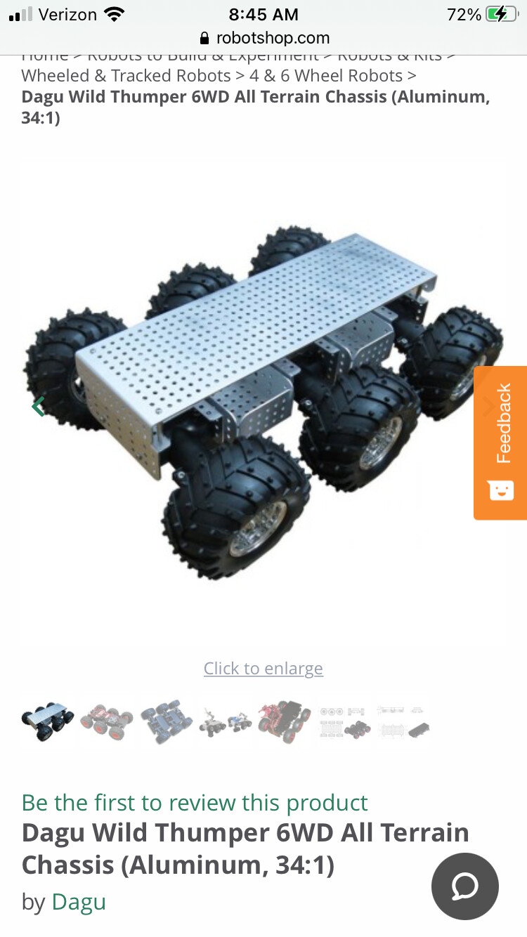

Some thoughts on the only articulated 6WD chassis currently doing inspection work.

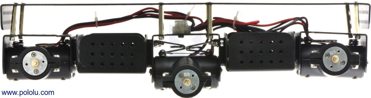

The Dagu Wild Thumper 6WD is a hybrid of “box bots”, and off road rovers. It is a modular machine assembled from three drive modules, and two equipment bays. Each drive module houses a pair of semi-independent suspension motor drive assemblies, linked by spring and wire such that they influence each other under flex, but are not firmly connected. The center module locates the wheels a little bit higher than the end modules. This is advertised as a way to reduce loads on those wheels when crossing obstacles.
Each wheel is driven by its own open can motor, placed within the stem of a T-shaped tube laying horizontally. These motor mounts pivot up and down, working with the spring sandwiched between left and right motor housings. Open motor cans are designed to allow air cooling.
Steering is accomplished by varying the speed of the wheels on each side. Each set of three wheels works independent of the other. This is the same method of directional control utilized by tanks. It enables “zero turn” steering or, “spin on a dime”.
There is no motor controller included in the basic $300 kit at pololu.com. The controller is an add on at $46. R/C interface is extra. I didn’t look that one up.
Its internal equipment bays appear to be sufficient when combined with the space beneath the upper deck, and the tops of the bays. The metal used for all bays and deckwork is drilled throughout to allow for fixing components in and on the machine with common hardware.
Video of the machine shows it climbing stairs and crossing rough terrain reasonably well. On the surface, it appears to be a better implementation of tank hull design than the alumibox inspection rovers commonly for sale. There is somewhat more tolerance for obstacles that get lodged beneath its hull.
On close study, I decided on a thumbs down for several reasons.

The motors are an unbranded type, open can, and mated to a gear reduction box, to which the wheel adapters mount. They are inserted into the T bracket in line with the wheel’s axis. This positions them much lower than the motors you find in rock crawler adaptations. Take away? They are subject to much more water and mud intrusion, and once infiltrated, I see no easy way to service them. There are six of them to protect, and all are open can for cooling purposes. Disassembly of one suffering failure or degradation requires disassembly of all, since they share the same vulnerabilities. Replacement must be through the supply chain since a functional match is required. Initially, they appear to work well. As time goes by, though, and foreign material passes through them, I expect to see one or more wheels dragging. Rock crawler chassis conversions position their single motors much higher. They are better protected, and easier to service or upgrade. There are even sealed units with feedback circuits for fine motor control. Hobbywing Fusion or Axe are great examples.
Wheels.
The wheels are affixed to the gear boxes via adapters. The adapters, as supplied, use a single grub screw to anchor to the shafts. Six single point mounting methods that rely on clamping force. Rock crawlers use locking nuts on a fine threaded axle - much more secure.
