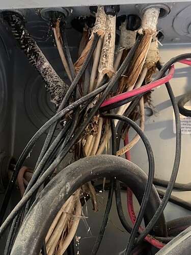

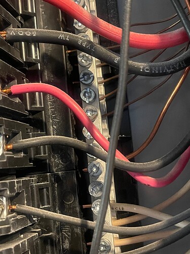

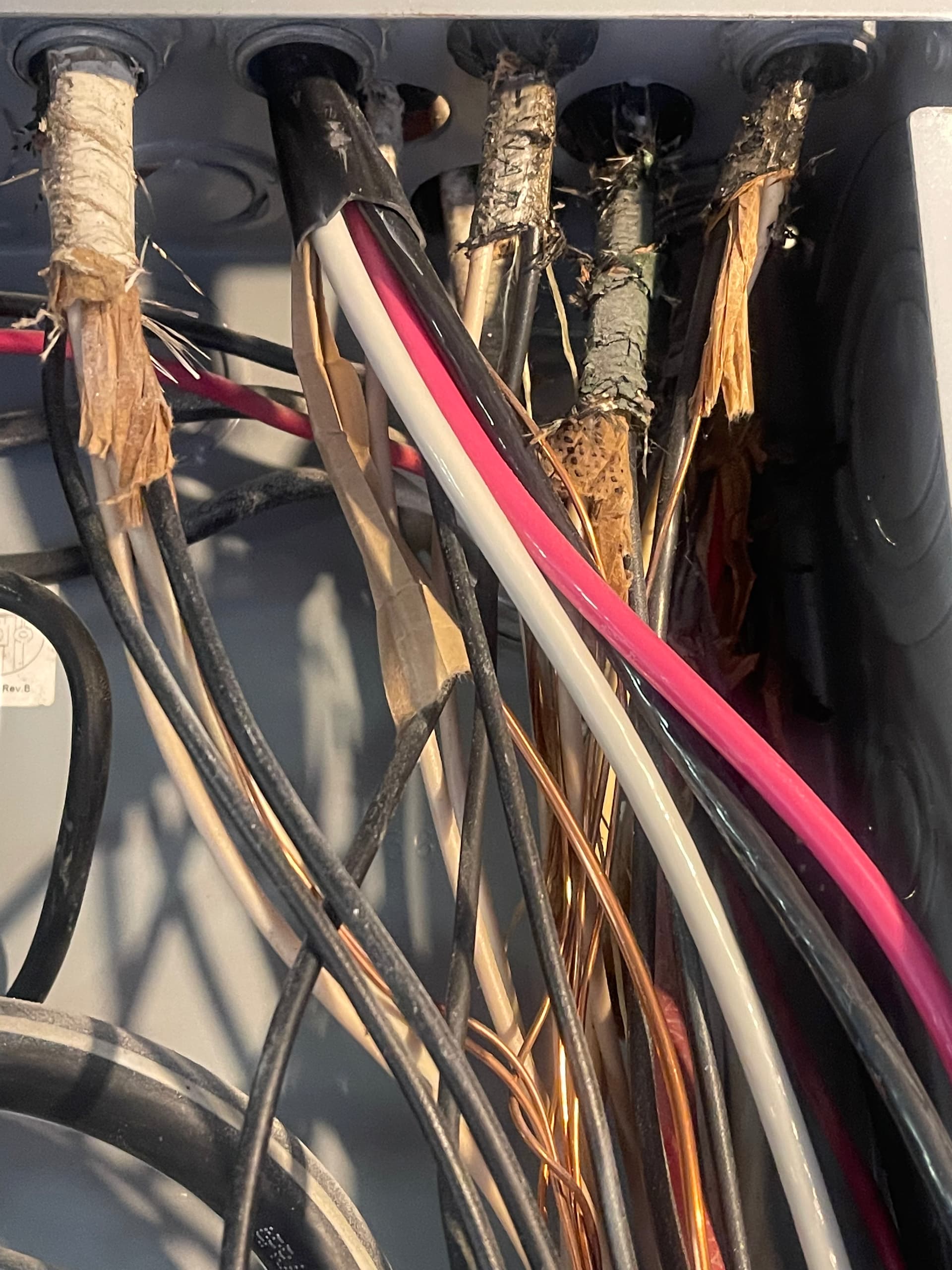

I’m not going to lie gentlemen and ladies, I took off my first electrical panel (currently doing my mock inspections), this was a little intimidating. I found myself looking double taps, damaged breakers and conductors, labels and inspected the screws that I took out. Also I did notice the bare conductors on the grounding bus (seen in two pictures) are they a problem? And the Rolex at the top of the box looked old and damaged. First part of the mock inspection I actually questioned myself on.
For your report you might consider a total panel picture (dead front removed) with circles or arrows indicating defect areas and then include close up photos if you want. It is hard to see the whole picture with just close ups.
I would definitely recommend updating the older wire. The insulation has degraded and most likely degraded all thorough the house.
I don’t see any double taps in your photos. If this is a service then the bare EGC’s can be landed on the neutral bus. The NM cable (Romex) has thermoplastic conductors which should last 100 years so they are probably fine.

Well, I don’t see a rolex, but I also don’t see anything wrong with the pictures you posted, except for a couple missing bushings at the panel openings.

I would recommend you read further about double taps. Some breakers are designed for this and it’s important you can recognize the difference. It’s a common mistake.
I would like to see the “damaged” breaker.

I agree with Robert and Daniel in that from this set of pictures there isn’t a lot to be concerned about besides the lack of insulating bushings at some of the fittings. There could be other problems lurking in what is not pictured though.

Unfortunately, the first panel you elected to open is old and has been upgraded. It has wire you will never see again at Home Depot, so you have no reference to the product.
Possibly the whole panel was changed, thus the condition of the old fabric/paper insulated wires (prior to 1960’s).
Did you look at the wall outlets in the house. Two prong or three? Did you test the three prong grounding if there? Outlet boxes were commonly metal during that time. The ground was often terminated at the box, not the plug outlet (or just wrapped around the cable). You will also note the ground conductor is much smaller then, than now.
There are missing cable entry connectors which can cause damage to conductors. There is a taped Neutral conductor that was damaged because of this (not serious because the conductor and panel are grounded).

These are the type of things you need to consider, not fabric NMC w/o visual defect.

It would certainly be prudent to know if you are looking at a service or a distribution panel. This can tell whether grounds are allowed on the neutral bar or need to be on a separate ground bar. It will also be a clue as to whether the bond screw or strap needs to be in place.

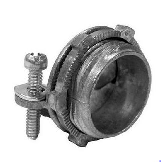

Bushing are different than cable connectors. Bushing go over the threads of connectors, but are not always needed. Cable connectors are needed.

The only thing wrong I see from this pictures is the missing bushings. If this is not a sub panel the white wire is fine. Don’t see any breakers, those breaker ends are fine.
