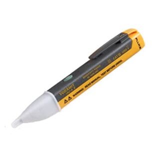

Use a non contact volt tester. :thinking:Little easier on your heart.
I use: Fluke 1AC II Volt-Alert AC Non-Contact Voltage Tester.
I got one, I was just asking for academic reasons
Academically speaking of course, physically touching a dead front, or any other bonded conductive surface to judge the presence of electric current or voltage is unwise if/when current may exist, and a foolish practice mind you, if/when you carry a non contact volt tester.

IMO this back of the hand method should be removed from any type of training manual. A proximity type, non-contact tester is $15. Testing with a tester should be the primary way to determine that something is safe not using any part of the human body.
