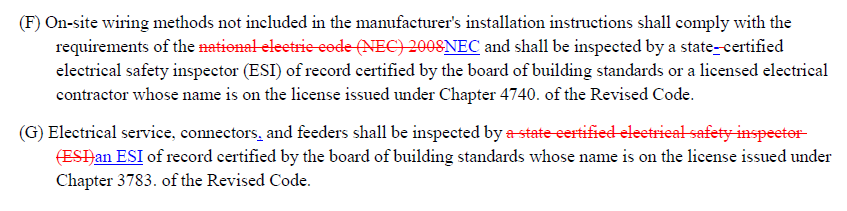

(B) The “practice of electrical inspection” includes any ascertainment of compliance with the Ohio building code, or the electrical code of a political subdivision of this state by a person, who, for compensation, inspects the construction and installation of electrical conductors, fittings, devices, and fixtures for light, heat or power services equipment, or the installation, alteration, replacement, maintenance, or repair of any electrical wiring and equipment that is subject to any of the aforementioned codes.
You can remove the cover. You just can’t comment on “the construction and installation of electrical conductors, fittings, devices, and fixtures for light, heat or power services equipment, or the installation, alteration, replacement, maintenance, or repair of any electrical wiring and equipment that is subject to any of the aforementioned codes.”
Please provide any statement from the State of Ohio that says that I am wrong.

The only exception in Ohio law is found in the OAC:
https://com.ohio.gov/documents/4781$0-6-03.7-Rule-AM.pdf

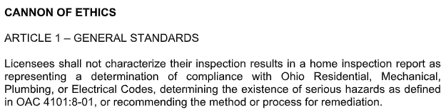

Here is the language that OBBS provided to OHIB that never got shared with the state holders.
COE
This will be the law of the land by the time that this is all decided. I’m just giving you the heads up. Accept it or not.
That isn’t what you stated months ago.
Do you remember this…
"“However, if a person holds them self out as a home inspector and offers to perform an inspection of the home and its systems but indicates that they will issue a report indicating the state of function, operation or relative hazards, but not refer to code compliance, they would not be in violation of this law.” "
