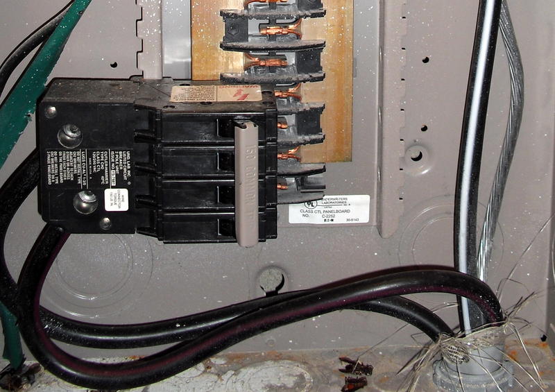

Clearly an electrician to NOT recommend. But, would the service to the subpanel still be considered 200 amp, even though the common trip from the main is 150? The whole thing smells wrong to me. Buyers are going in with eyes wide open, but…
The capacity of the subpanel is based on the rating of the OCPD ahead of the subpanel feeder and the feeder conductors. What size wire is feeding the sub?
Since it’s copper I’m assuming that it’s in a raceway and not SE cable since copper SE cable is a rarity in New Jersey. Are there 4 conductors in the feeder?
Yes, 4 wires, 2 coming from the common trip. I’ve attached a closeup photo of the main panel, but since its my first attempt at uploading, we’ll see if it came out OK.
So this photo is of the 150 amp CB in the service that is feeding the subpanel? From the bare EGC that looks like Aluminum SER cable. Under the 2008 NEC that cable would need to be used at it’s 60° C ampacity in Table 310.16. The appropriate ampacities are as follows for interior SE cable with Al conductors:
