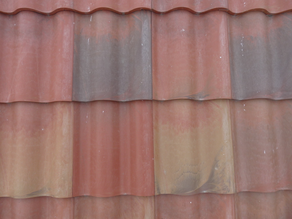

I can’t even tell what material they are.
I think #1 is clay, but it looks pretty thin.

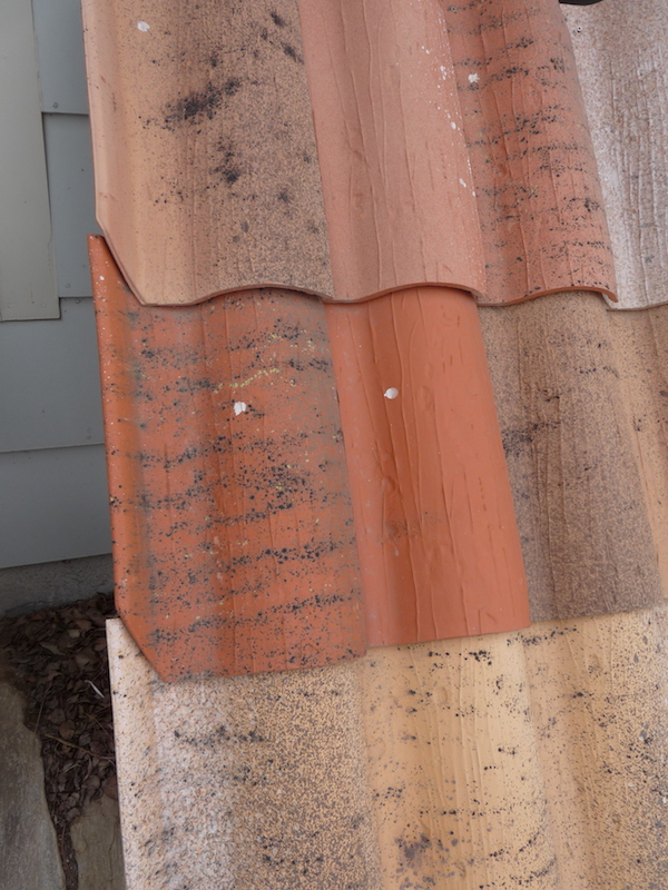

I’m pretty sure 2&3 are composite because the edges are so straight, the joints fit so closely, and there are almost no imperfections like chips.

Hard to tell from the photos, but your assessment seems reasonable. Normally see the tiles staggered, unlike photo #3.
They all look like Terra Cotta clay tile.
That’s it, Bill. Can’t be too many with that type of joint. Thanks!
Still not sure about #1 though.
Composite IMO.
