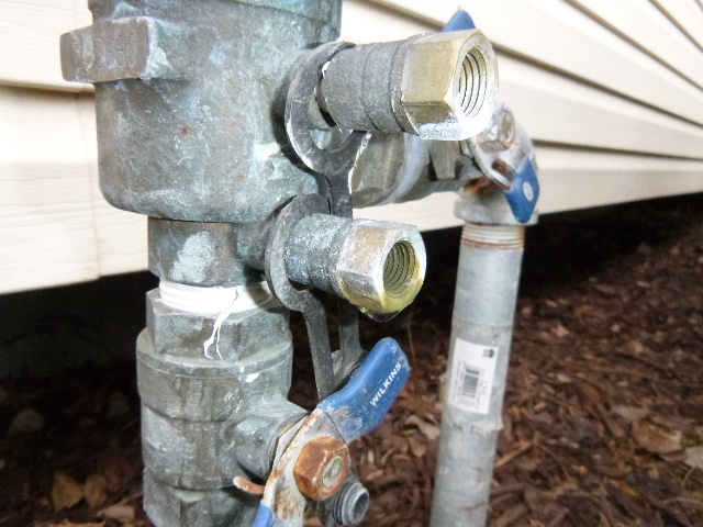

Attached is a pic of the sprinkler anti-siphon assembly. It was noted that it had a drip coming off one of the ports. The main valve for this system was in the off position, as it should be for the winter season. It was reported that the main valve may be leaking.

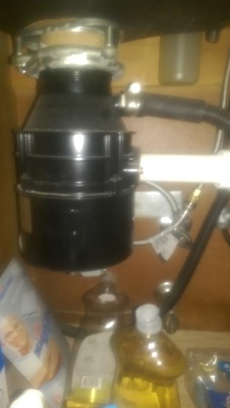

This garbage disposal is relatively new with no signs of rust or leaking. Its operation is also good.

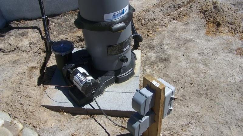

example of a pool pump bonded to the above ground pool.

For my additional reading, I read more into food-waste disposers.
This is a picture of the food-waste disposer installed beneath the double sink in my kitchen.
During my visual inspection, I saw that the rubber insert was in place. There were no leaks. The drain pipe was 1-1/2", and there was a trap installed. It was hard wired into a dedicated circuit.
