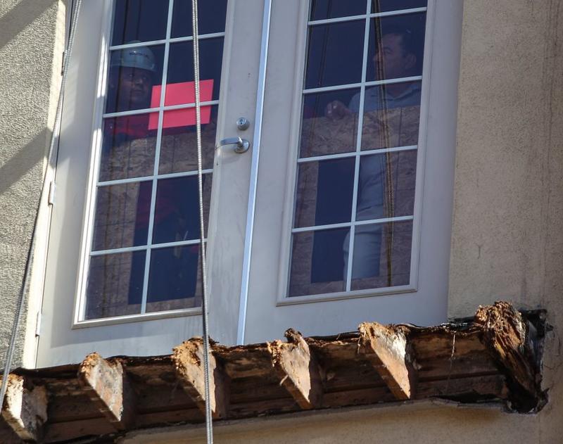

Here is a close up of the failed balcony, the internal structure was completely invisible as it was covered from above and below. No way to inspect it visually.
Seems like a design that is almost destined to fail without warning.
An exterior hidden wood support structure that will almost certainly be experiencing
moisture intrusion unless it was built flawlessly.
Easy to say in hindsight but should have had at least some steel in that support structure. That wood isn’t even pressure treated!
Very sad and of course preventable.
Looking at the photo the exposed wood has obvious water damaged. The other photos show a rubber membrane that covered the deck. My guess would be the design was adequate but the flashing details allow water under the rubber membrane. Trapped water in an enclosed environment will accelerate wood rot. I hope they notified everyone not to use their balconies.

Devil is always in the details, IMHO the design is flawed as that assumes perfect flashing. We all know how often that happens, Not.
It also assumes no damage to membrane/flashing after construction, which is wishful thinking.
Never should have been made with KD lumber IMHO.

The way it was constructed made it very difficult to inspect, would have to be invasive inspection.
Again, using KD lumber in that situation instead of treated was the real design flaw.
On units like that perhaps they should consider inspection access
Totally agree Wayne, but that would have required forward thinking and the lack of that is what doomed those kids.

Here’s a good article in the LA Times on the balcony collapse.
Structural engineer says “It appears to be a classic case of dry rot, meaning water intruded into the building [and] rotted the wood”
I agree, decay, probably from bad flashing. Sound wood would show a lot of splinters and not be dark colored. There probably wouldn’t be any warning like cracking. It would suddenly snap off and fall.
