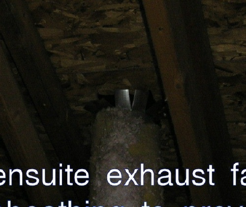

When I inspected this home and saw this particular bathroom exhaust vent, I recommended the flange be properly installed. Agree?
Yep.
