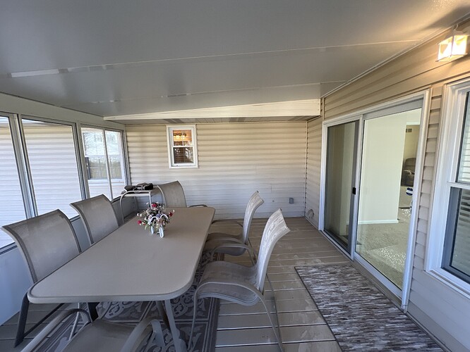

I called out a bathroom window venting inside house as not properly venting to the exterior of the house. But could it be acceptable to vent in a sun room?
Was it a full bath and was there a mechanical vent?
IMO, with the exception of the lack of prvacy, the window is a non-issue.
With no other mechanical ventilation, I would say no, you cannot vent to another finished space.
I do know that if the boys were over after Taco night, I think the sun room would be a no-go zone.
That said, it looks like that window is below a soffit, so you would in effect be venting INTO a soffit and that’s not permissible in Florida anyway. I dunno about elsewhere.
Compliant or not, it’s a bad idea. Moisture and odors will emit from that window.

There was a mechanical vent, that’s also why I said keep window closed, and blinds covered when using bathroom for privacy.
Fortunately it did have a power vent going onto attic, (that was called out) but the idea of a bathroom window going to sunroom was not well thought out on the contractors part.
The sunroom is a kit that was likely added on after its original construction. My mother has a similar situation, except in her case, it is the kitchen window. None issue.

With that said, I think the bathroom vent goes back to your local code requirements. If it was required at the time of construction to vent to the exterior, it shouldn’t be altered.

Bathrooms need to be vented. Although an openable window is allowed for the vent in today’s energy conscious world it is a bad idea.to allow unconditioned air into the bath while using it. In heating climates it would simply not be opened when needed. Mechanical vents can’t vent to any enclosed space. No reason to call out the bathroom window if there is a separate mechanical vent.
Agreed and I do mention that in my reports, however I do also mention that it may not have been required at the time of construction and it’s up to the client if they want to install one. Not up to the seller.
Than in my opinion, I wouldn’t even mention the window. It is odd, but that’s about it.
Same here. This is a non-issue.

So are you looking at it as a privacy issue, or a vent issue? The bathroom has a mech vent so not sure why you would open the window to the sunroom where the guests are sitting. But even then, no different than a guest not doing any venting and then leaving the bath door open upon exiting the stink chamber. ![]()

It’s still not a functional deficiency issue, rather a design issue.
Cosmetics & design do not make my report.
