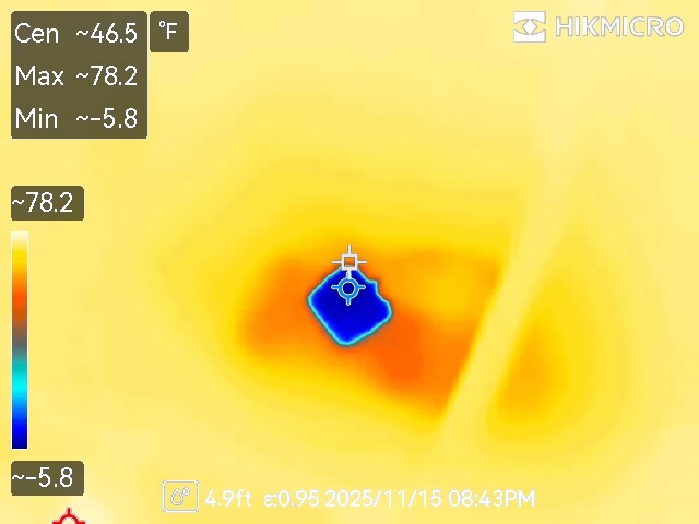

I use a HikMicro Pocket 2. For what I do with it, it’s enough. It’s got decent specs and at 256x192 the resolution is one of them. I have found water issues with it and use it to image the electric panel to help identify any breaker issues. The battery life is great and the screen and sensor resolution is a step up over the competing $600 Flir( C3-X 128x96) or $700(C5 160×120) products. The Pocket 2 costs about $550.
