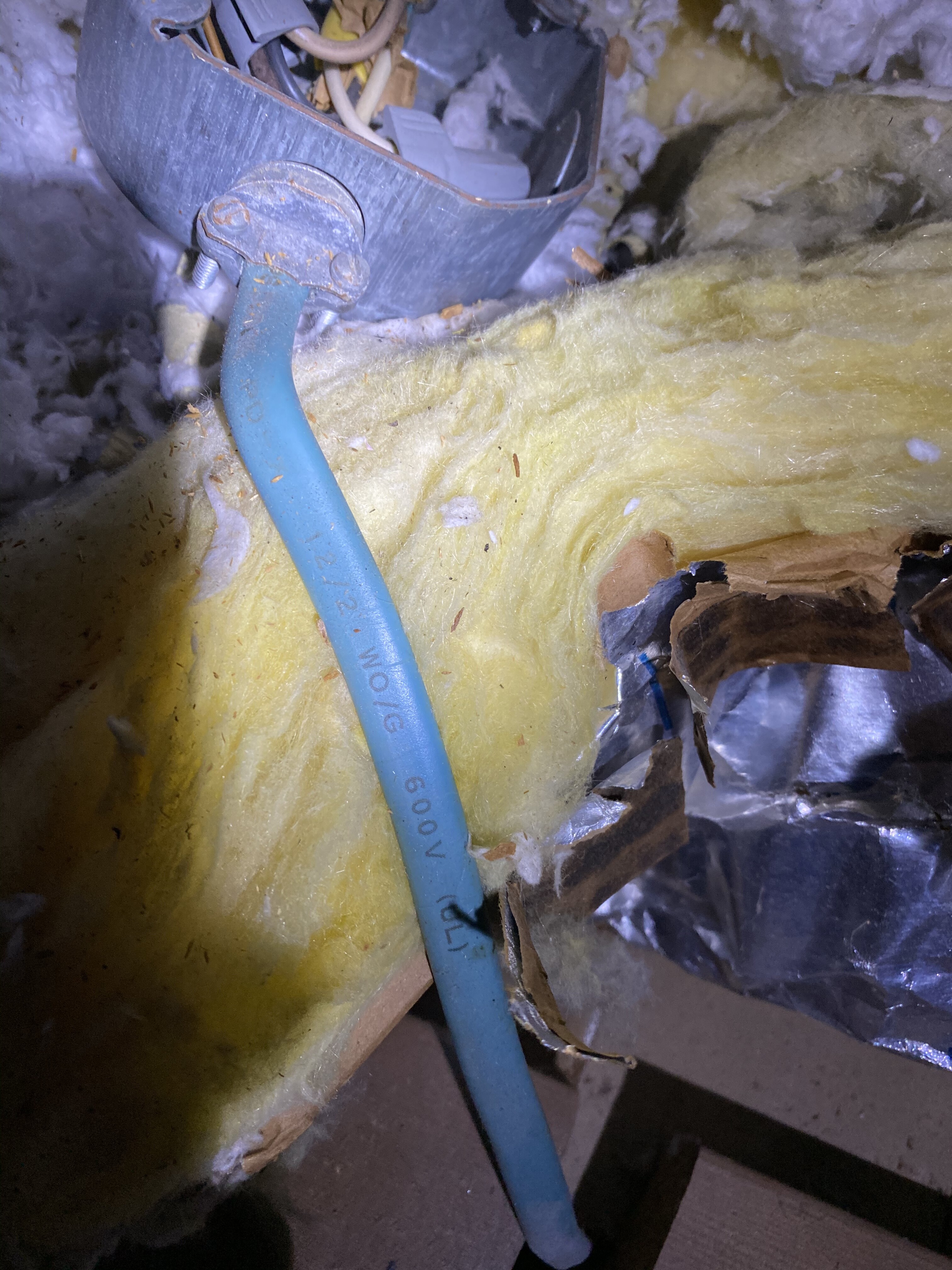

I just bought a house sight unseen since I was out of state and could not inspect myself at the time and am not licensed in the state of Florida to be a legal inspection it appears the home inspector missed several ungrounded outlets in the home. I am doing some remodeling of the house and discovered many of the rooms are ungrounded and started looking at the wiring and noticed blue Romex style NM conductor. Unfortunately the outlets affected are in the outside walls of a block built house. Its not going to be easy to fix. Just wondering if anyone has seen this blue conductor before and if so, is it always ungrounded? I noticed he didn’t call it out in the report and clearly to me he didn’t test a representative number of outlets since many of the rooms don’t have a single outlet that is grounded. The house was vacant at the time of inspection.

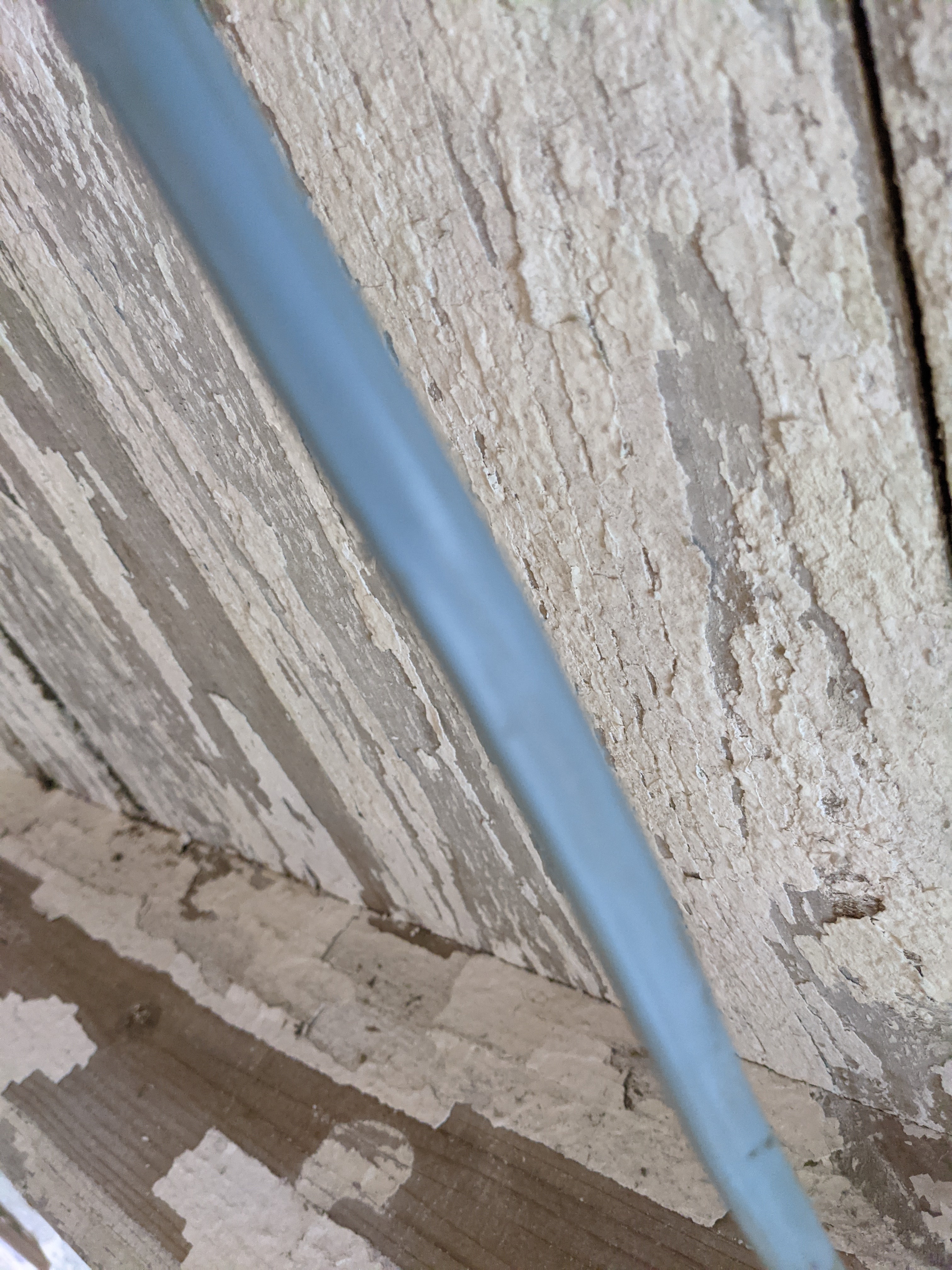

I think Larry might be referring to the color of the jacket, not the individual wire insulation.
Is this the color you’re talking about, Larry? (I have a few feet of this still energizing a couple troffers in my barn - can’t remember if it had a ground or not.)

Sounds like UF cable which typically has bluish gray jacket.

Looks new enough that there should have been a ground.
@lthompson7 Would that open junction box have the answer inside?
It says 12/2 WO/G on the sheathing…
Thanks Larry, I just looked at the plastic sheath, but not a closeup.
