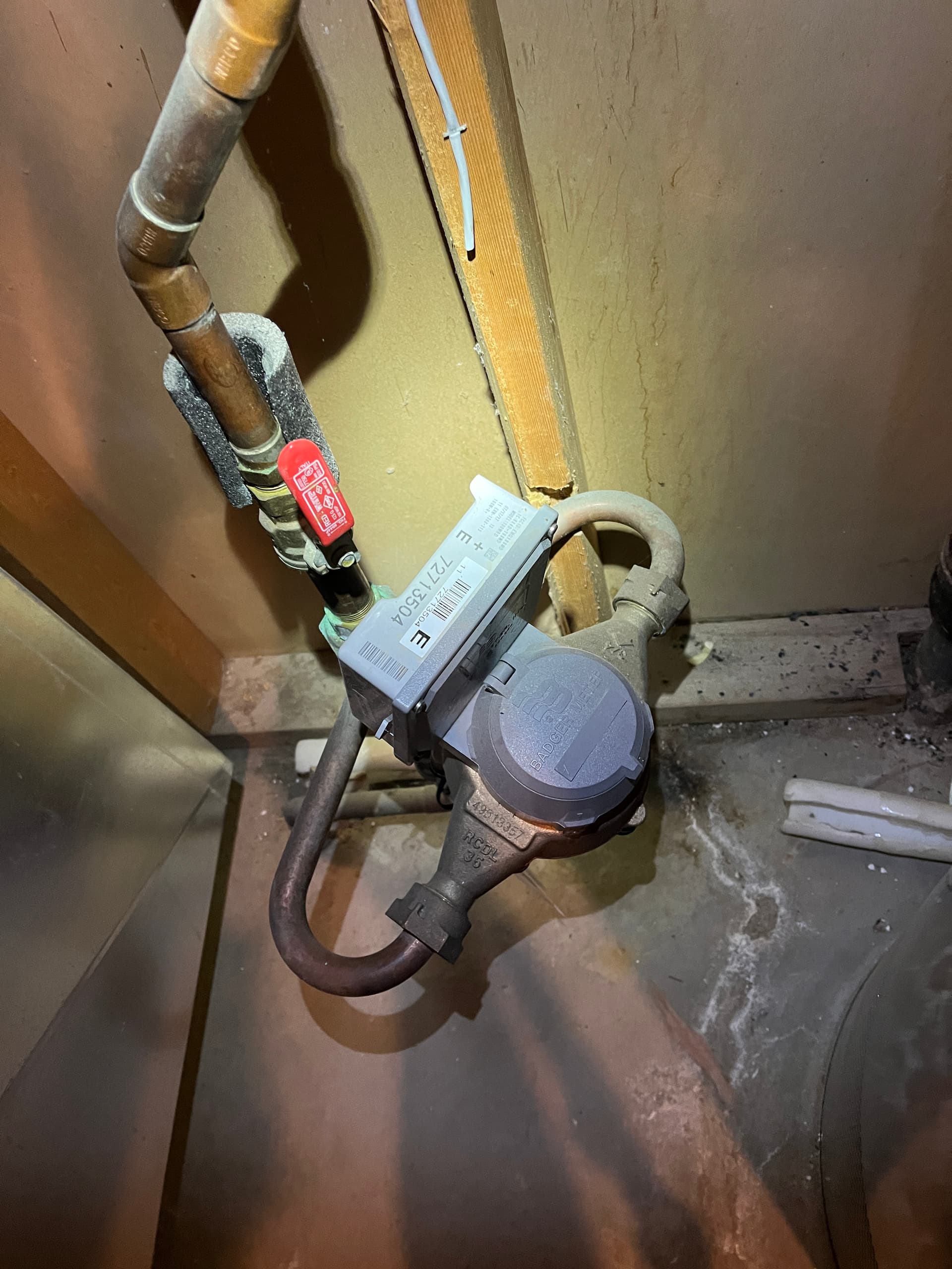

The grounding electrode was the copper water pipes in the home, I am considering if I need to call out a missing bonding jumper at the water meter. My hesitation is that this meter has a “cut it” loop, does this type of meter need a bonding jumper? I rarely see this style of meter with the integrated loop otherwise I would call out the missing bonding jumper at the meter. Thanks!
Service pipe 3/4" Copper, branch lines copper
Here’s the actual code requirement. Doesn’t appear that this setup requires a bonding jumper.
250.53(D) Metal Underground Water Pipe. If used as a grounding electrode, metal underground water pipe shall meet the requirements of 250.53(D)(1) and (D)(2).
(1) Continuity. Continuity of the grounding path or the bonding connection to interior piping shall not rely on water meters or filtering devices and similar equipment.

The NEC would also not require the CEE to be supplemented. It is a standalone means. Was the incoming water still metallic?
Good point. I hesitate to answer because a continuous bond seems to be in place.
A typical setup would be; valve, pipe, adapter, meter nipple, meter, meter nipple, adapter, pipe, valve, house.
You are not out of the woods with plumbing issues. I see two leaks at threads.

Thanks Robert, no active leaks were present in this picture, and the evidence of a past leak was reported on accordingly and I recommended to monitor the area for any potential future leaks. I don’t recommend a plumber at every past leak I see in a structure as I do not want to over report. If I were to do so nearly every inspection I would be recommending a plumber and this would not benefit my clients. However, every situation is different and it’s a judgment call for me to discern. Thanks. :slightly_smiling_face:
