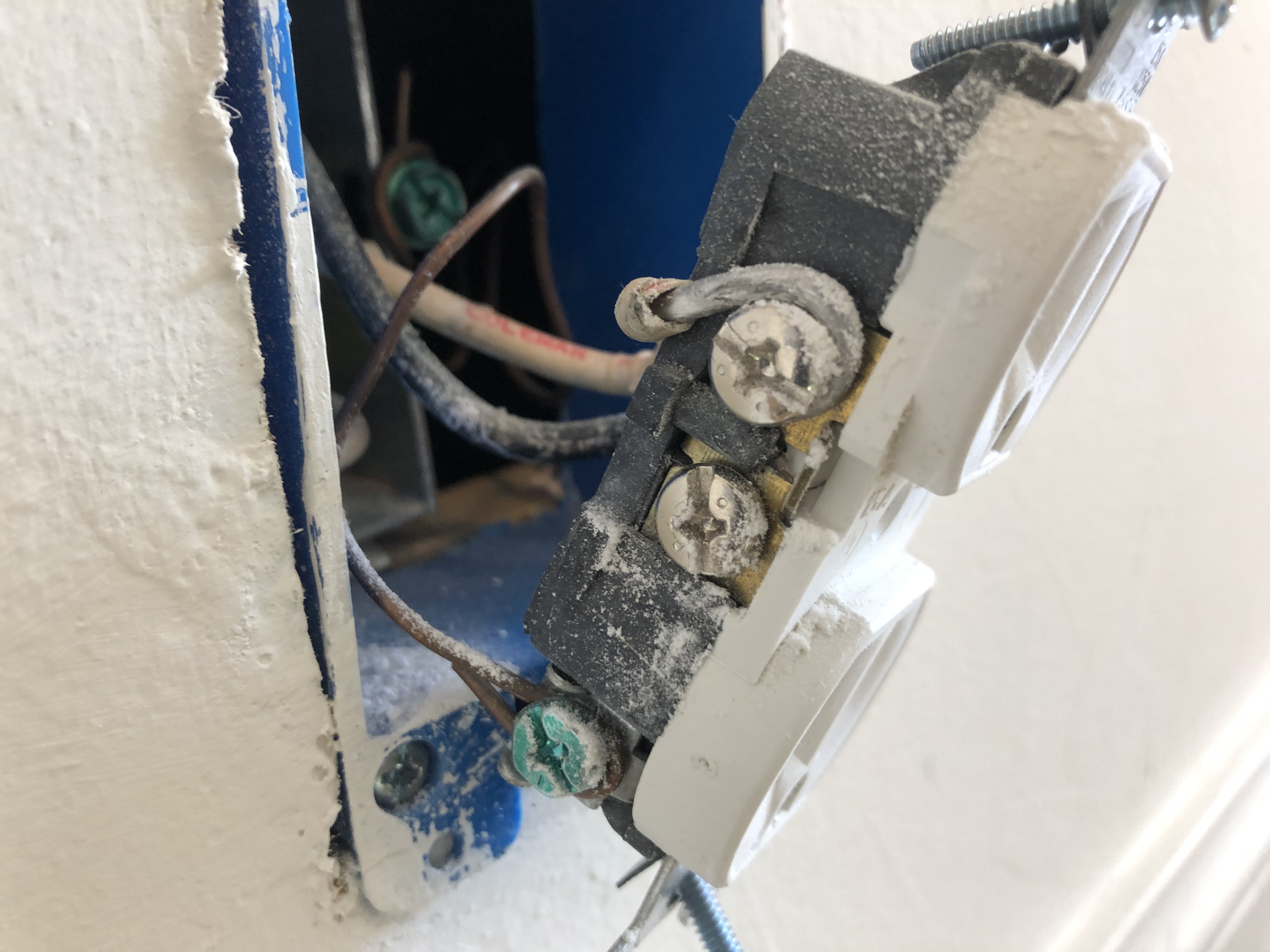

Are these Co-Palum connectors. Does the branch circuit wiring for the outlets also need to be retrofitted.
Those are alumicon connectors by king innovation. Odd that they are in the panel. The breakera are likely rated AL/CU but the devices are not. I can tell by the screws on them. The branch wiring should be remediated by a licensed electrical contractor.
I see paint contamination

Thanks on the paint contamination. Also, this is in a condo, it is the sub-panel, to the main service panel. Should the green ground screw have been removed?
Gloria, that appears to be bonding the grounding (bare) conductors to the cabinet. The grounded (neutral) conductors should be separated from the cabinet in a remote distribution (sub) panel board.

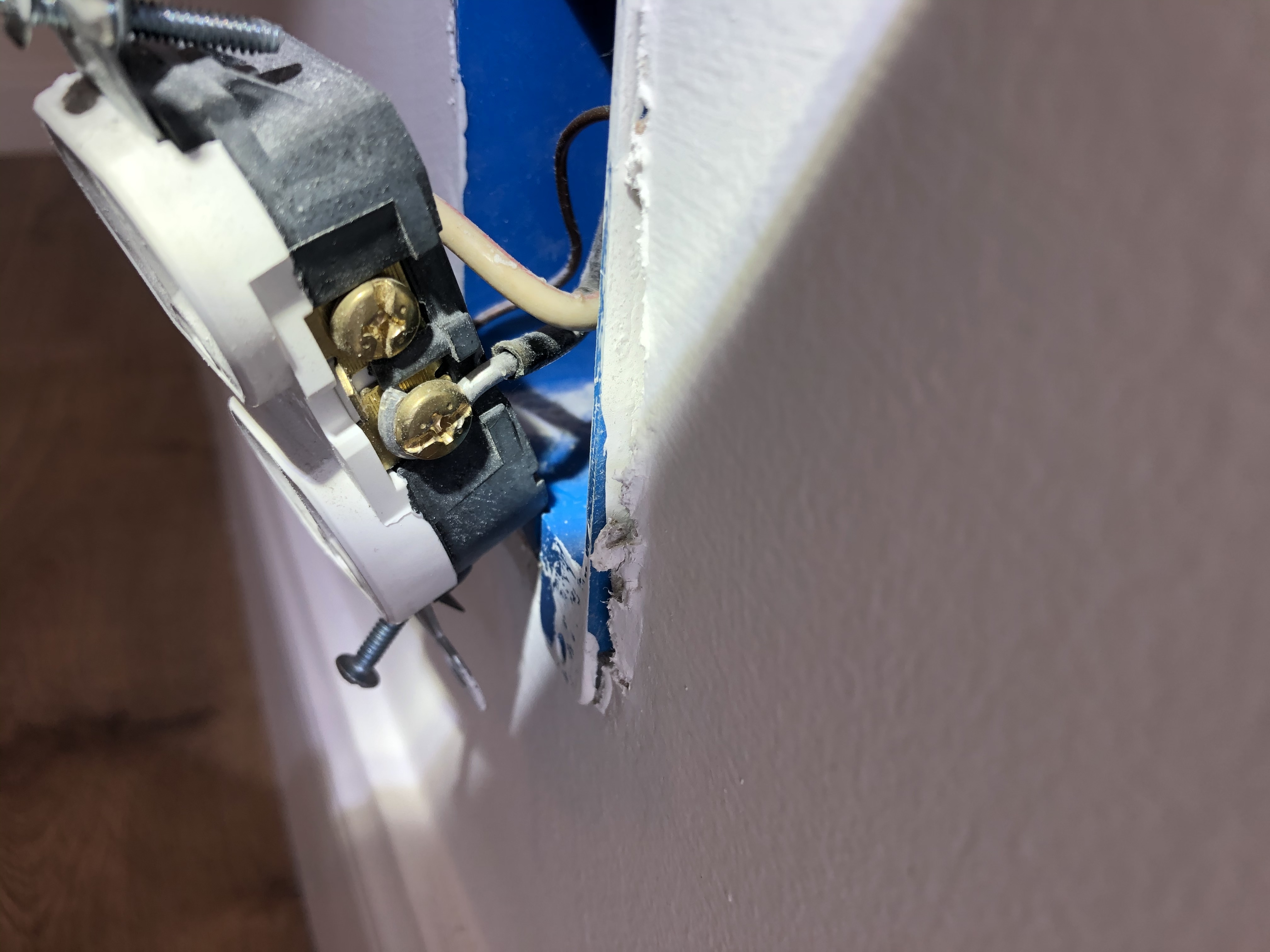

Just curious. Did you remove the outlets to check or were they already not secured to the boxes?
Something is also fishy about the way the outlets are set in the boxes. Looks like extension rings that do not align with the box behind it leaving a gap open into the wall cavity - which is a fire hazard.
It is a old work box.
I take that back i see it now
The good news is that this does not have to be difficult. When you see or suspect something wrong, write it up for further evaluation and correction by a (in this case) licensed electrician. Copalum connections are a crimp connection. Copalum is a franchise and most electricians do not have the franchise. Any electrician (or handyman) can use the alumicon connections. Done properly, the alumicon work fine, though the Copalum is considered superior; they too, have to be done correctly.

I did remove the outlet using the proper PPE.
