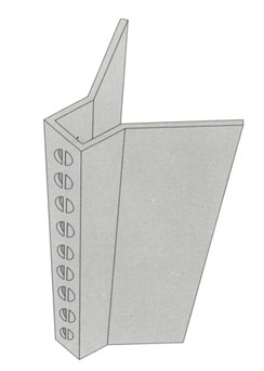

This may help some.
[FONT=Arial][size=5][FONT=Arial][size=5]WEEPS
[/size][/FONT][/size][/FONT][FONT=ArialMT][size=2][FONT=ArialMT][size=2]Although open head joint weeps are the recommended type of weep, some weeps are made using plastic or
metal tubes, or using rope wicks. These alternate weeps should be spaced more closely as they do not drain
water as quickly. Weep openings are permitted by most building codes to have a minimum diameter of [/size][/FONT][/size][/FONT]
[FONT=Arial][size=1][FONT=Arial][size=1]3
[/size][/FONT][/size][/FONT][FONT=ArialMT][size=2][FONT=ArialMT][size=2]/[/size][/FONT][/size][/FONT]**[FONT=Arial][size=1][FONT=Arial][size=1]16 **[/size][/FONT][/size][/FONT][FONT=ArialMT][size=2][FONT=ArialMT][size=2]in (4.8
mm). Rope wicks should be at least 16 in. (406 mm) long and made from cotton sash cord or other materials that
wick. Items used to form weeps should not easily deteriorate or stain the brickwork. Open head joint weeps may
have non-corrosive plastic, mesh or metal screens installed if desired. Vent-type weeps can serve a dual function[/size]
of allowing water to drain, but can also allow air to enter the cavity resulting in more drying action. There is no
single method that produces the best weep for all situations.
There are numerous designs for weep hole inserts, and depending on the geographical area of the Country, certain designs are better than others.
In some areas they may need this’
http://www.tamlyn.com/documents/WeepHmouse.htm
and one more here;
http://www.tamlyn.com/documents/weephcomerical.htm

Weep holes are recommended by the brick institute and required by code.
The requirement of what type of weep holes in brick is left up to a designer or local jurisdiction.
Not one particular type of weep hole design is mandated that I know of. The presence of a weep is all that matters.
