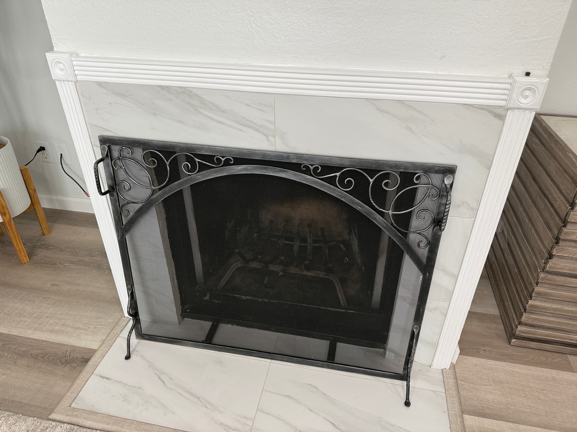

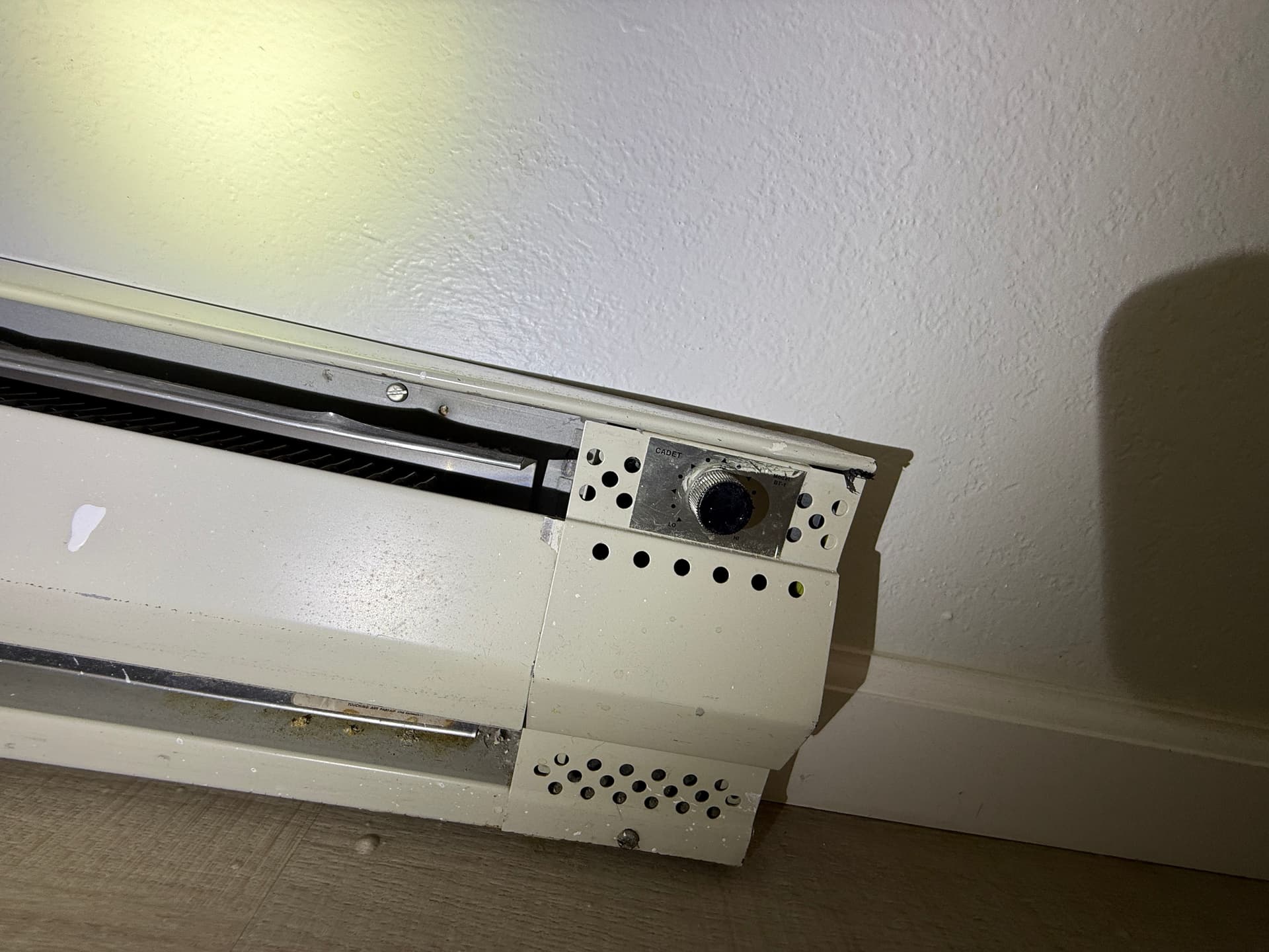

Condo / 1974 build 1000 sq ft, 2 levels. I noticed these bumps/blisters on the flooring when I first open the front door so I took a picture thinking it was a defect. Then I noticed it was everywhere, 1st and 2nd floor, and my second instinct was that it was an intentional feature. I couldn’t imagine why it would be intentional though. I’ve looked online and can’t find any flooring that’s purposely blistered like this so now I’m back to believing it’s a defect, but these bumps appear to be manufactured to me, not a defect bump. I did find examples of flooring that was blistering but it didn’t look this flooring. I’m so confused :slight_smile:
Have any of you seen this and determined if it’s a defect or an intentionally manufactured product? A couple pictures are a little far away but you can still see what I’m talking about.
