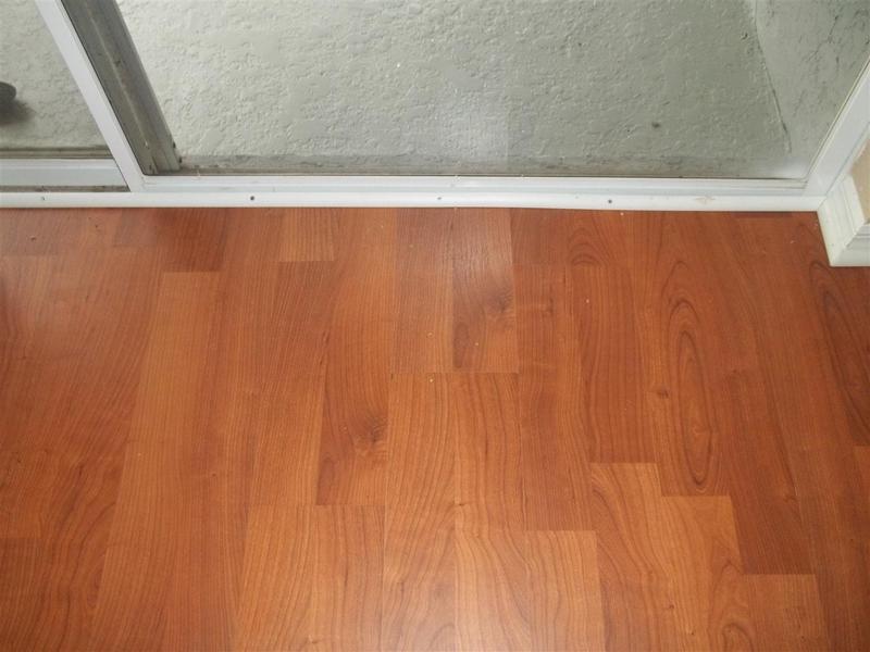

The floors below are from yesterdays inspection. Laminate flooring, but same thing. Nothing was done right from the trim the to door frames to the proper staggering of the boards.
