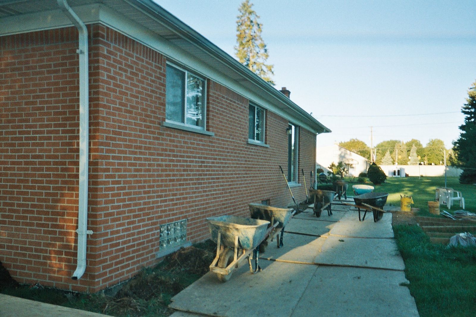

Underground tree root caused foundation crack’s, caused leaky basement.
http://picasaweb.google.com/101049034584960315932/BasementWaterproofing09#5442183457360199010
See it? :mrgreen:
Here, root now removed, eyeball crack
http://picasaweb.google.com/101049034584960315932/BasementWaterproofing09#5442183481473676082
Follow crack around corner…
http://picasaweb.google.com/101049034584960315932/BasementWaterproofing09#5442183587752619026
And…
http://picasaweb.google.com/101049034584960315932/BasementWaterproofing09#5442183604679367970

tree root caused exterior crack block basement wall, then the homeowner got water in this corner
back corner
now removed
… and so the answer is
