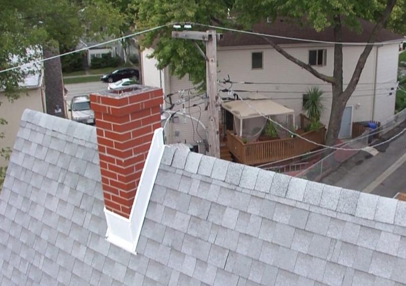

Does anyone know if the clay tile liner is required to extend any certain amount past the cap .
Picture is from my video pole for obvious reasons.

Your PIC doesn’t show a “cap.” However the liner should extend 2" above the crown, splay or wash. Source: http://www.nachi.org/comsop.htm#17 17.8.6.4.

If it is a double wythe brick chimney it is not required.
all the way to the down BOB.
A single width chimney or a gas or other inset a liner of ( galvanized or stainless ) The second choice being the best , is required and HIGHLY RECOMMEND.
The gas burns as a lower temperature and the exhaust is highly toxic and acidic and will eat through clay tera-coata liners and brick very quickly. The repair for such an event can be costly depending upon the repair needed.1.) No Concrete crown. Some call it a cap ( CROWN ).

The liner should be a minimum of 2" in your INACHI EXAMPLE .
I have seen specifications for the liner to be higher. 4" being a standard requirement.
I always installed the liners a minimum of 6" inches. It prevents back drafting in windy conditions.

Looks like an unlined chimney to me.
The liner is missing or never installed.
It was a flaunched cap on the stepped brick.
The stepped brick where to give the illusion of a crown.

SUSPECT: It is a single width chimney with no liners.
Now you have to look down the chimney to see if a liner was extracted and to look for deficiencies when inspecting. If you can.
Terracotta liners come in 2" foot sections.
Sometimes removed because it was deficient. Cracked.
No one replaced that top section? That is the hypotheses right now.

No actual cap and there is a clay tile liner that shows better on my video since I simply took a still off it for you guys.
I knew not having it extend was wrong as well as not having a cap if I read you right.
That is what I put in the report .I posted late because I had to do the report after my NACHI Chicago meeting.

Bill I already said it is clay tile but it apparently stopped to short and the clay tile liner can be seen if you have a bigger screen perhaps.
