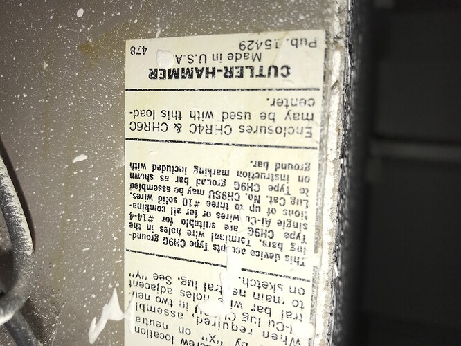

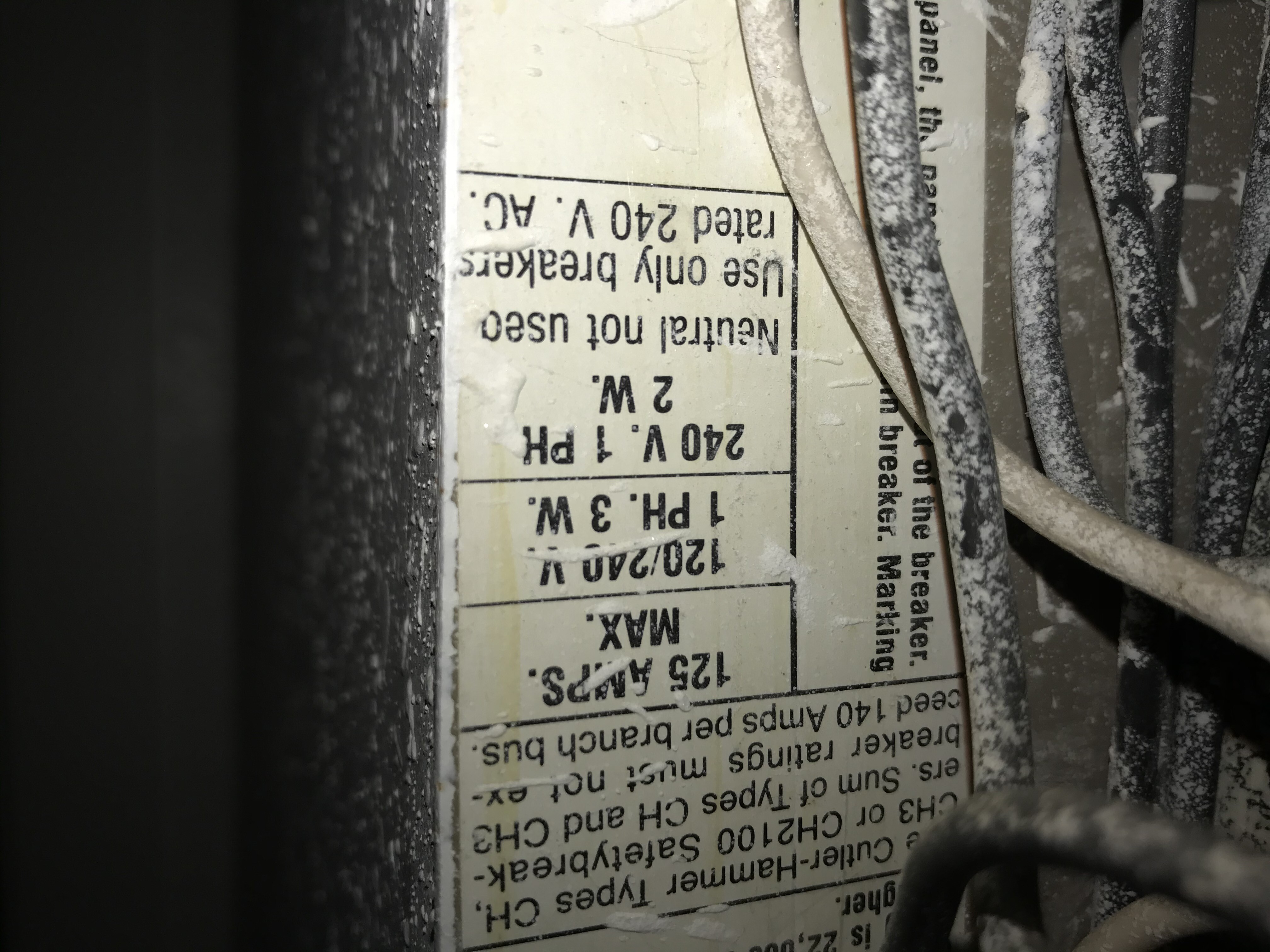

^Is this considered a double tap on a Cutler Hammer circuit breaker?^
^Is dividing a bare stranded aluminum grounding conductor allowed so that it can be fit under several different lugs on a grounding bus bar in a Cutler Hammer panel?
The manufacturer’s label did not appear to shed light on these issues.

From here that looks like a multi-strand AL conductor that is improperly installed but hard to tell.
Also that overspray is a problem.
A wider shot would be helpful, did you get any?

Usually when I see a multi-strand AL conductor, the entire thing is under one lug, and not usually split up under several different smaller lugs.

You’re correct about the multi-strand, if indeed that’s what it is, I really can’t definitively determine anything from the pictures you posted.
Kevin, I couldn’t tell much about the AL multi-strand either, other than to see that they all came from one hole at the bottom of the panel. No sheathing was visible for them.

I don’t believe that is acceptable.
And the overspray is a problem.
To accept 2 wires, I believe the breaker needs to look like this:

If all those strands are from one cable they should be terminated in one lug or hole in the bus. There are adapters for larger wire sizes to allow larger conductor terminations.
The side of the breakers will show if 2 conductors are acceptable and the sizes and materials allowed.
