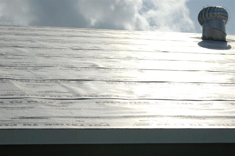

Same thing with SWR. All the roofers in this area say they install SWR and charge extra for it, and tout it as SWR on their invoice “save money on your insurance”. HOWEVER, they do not install tar paper over it. So, guess what? It’s NOT SWR. It is the primary underlayment and it has to be a 2nd barrier in order to qualify as SWR. So no one in my area should be given a SWR credit unless they can also prove tar paper was installed over it as required on the NOA doc. And no one here does that. I’m just waiting for a lawsuit on that one.
Don’t meant to appear like I am picking on you (not my intent), but, what data do you have to support your conclusion that majority of the errors favor the homeowner? If you have conclusive data that supports your position, please post here for all to see.
There should be a lawsuit as the OIR is in direct conflict with the building code as well as the manufacturer. All of the manufacturers state that you can install the peel and stick over the felt underlayment. The building code, at least in four different cities I am aware of, mandates it.
Evidently, this is yet another case of the OIR inventing their own interpretation of the English language.

Eric, The way I am reading the verbage on the NOA, the proper order should be plywood, peel & stick, tar paper, shingles. So the peel & stick would be the secondary, and tar paper the primary. Everyone here installs the peel & stick directly to the plywood, then shingles right over it. :shock:
If I’m reading your comments correctly, in your area it’s: plywood, tar or felt, peel & stick, shingle.
Per the OIR definition, the SWR must be applied directly to the decking.
For anyone to actually get SWR credit on the OIR, in South Florida they would have to have: 4" peel & stick on the seams, then paper or felt, then peel & stick sheeting, then shingles. In our area, they would have to have: 4" peel & stick on seams, then peel & stick sheeting, then shingles.
Good luck with that! Make things easy on yourselves and save yourself a lot of explaining, and just mark “NO” or “Unknown” on the OIR.

That is exactly what it is and it is the code. I instruct anyone who is getting a new roof, to install the peel and stick, over the seams, or there will be no discount.
Here is a tile roof application. There is a layer of 30lb paper under the peel and stick, then the tiles are foamed on to the peel and stick. This is code compliant and by definition, the peel and stick is the secondary layer as the first layer, the one of most importance, is nailed to the deck.
This guy never did get his SWR credit and he is an attorney.

If the peel and stick is applied directly to the roof deck then it is a SWR. Thats it. Nothing else matters. It does not say anywhere on the forum if and how much and what over lap is used on the felt.
The reason for an SWR is when the roof covering fails the wind cannot pull the peel in stick off the roof. The peel and stick prevents water from entering between the gaps in the playwood.
I do not agree that it should be that way.
Wood is NOT waterproofing therefore if all wood is not covered then it does not have Secondary water resistance.
