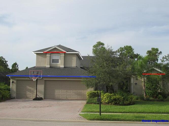

On a Wind Mit, when determining the roof perimeter, do you count on the lower roof or do you add the lower and upper roof perimeters together?
Answer: Add both together.
On a Wind Mit, for a clipped gable, do you count the entire length, or just the portion below the triangles at the ends.
Answer: Just the portion below the triangles at the end.

"The Second, third and fourth pictures are different partial views of a roof with a blue perimeter and red non-hip. Note that overlapping areas are not measured as part of the perimeter. "
whoopsie…
It was never in need of clearing up…for some of us…
As for the roof perimeter…there can only be one…and the answer they gave is incomplete. You add the areas together but you really don’t as most two-story homes, the first floor on one or in some instances, three sides, there is no lower roof perimeter.

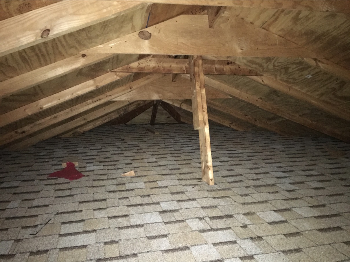

Now that you mention it, I was called last week to do a wind mitigation (post closing and previously inspected) and found (see photo) in the attic. Complete mess.
Owner is furious this wasn’t found during her $425 home inspection.
Obviously this attic is a mess. I’ve never seen anything like it. My question is on a home inspection how would you write it up? Insufficient engineering, recommend further evaluation by a licensed engineer.
I found the same condition once. My client purchased the subsequent house I inspected for him.
