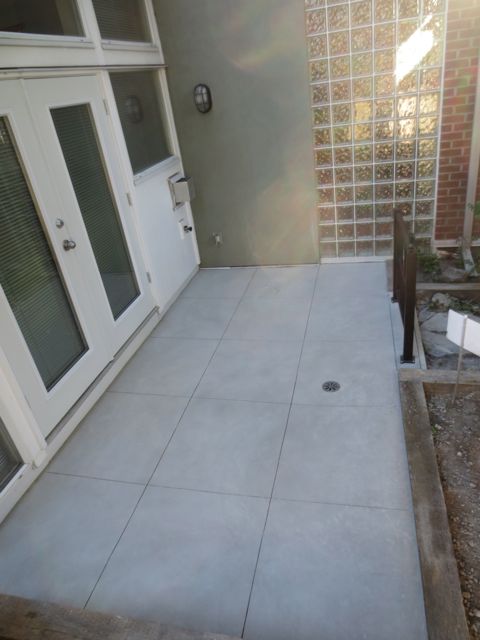

The owner of this condo here in Vancouver didn’t like his patio - so he had a new 1.5" topping poured over the old.
I can see he correctly used a bond breaker, and notched the drain to permit drainage from between the two pieces.
My concerns:
  1. When I tapped it, there was a hollow area near the base of the door. I believe he may have poured the topper over pavers sitting on the soil. Settlement? Will it eventually crack?

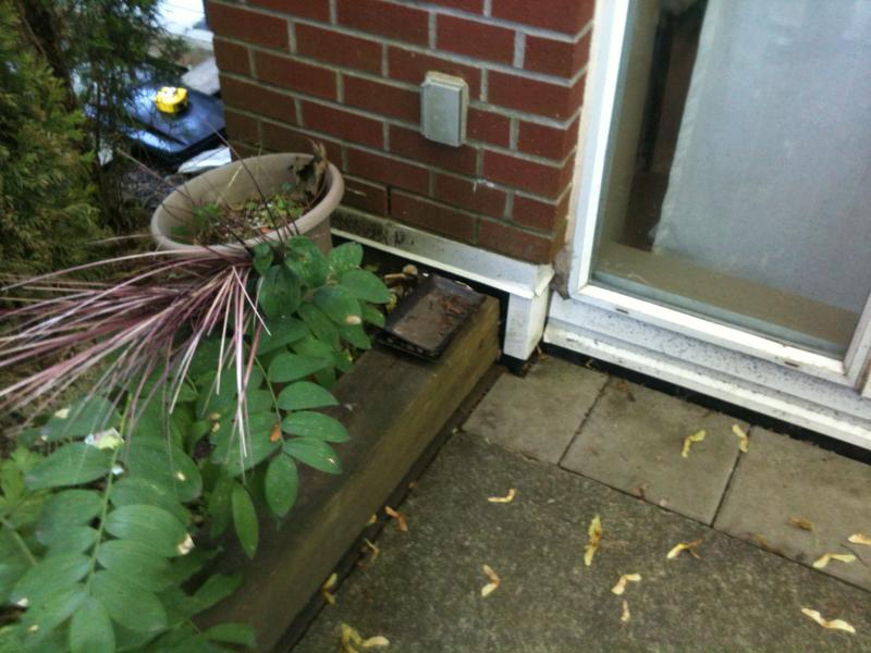

  2. He’s buried the metal flashing near the house (see photos). What will happen to this flashing over the long term?
Thanks for any help!
PS: Photo #1 shows neighbouring unit which is how his looked before.

Metal flashing that is present will eventually rust and deteriorate.
There should have been an expansion board placed between the exterior wall and the concrete pad. This would allow the concrete to swell and contract without pressing directly on the wall.

Not sure that an expansion joint is needed at the wall. That pour is not really large enough for that, and it is open on two sides…should be sealed at that connection for water intrusion though. The dissimilar base layer (pavers, if present) for the toping coat may crack at that joint in the future. Looks like a fairly professional install that may or may not have a problem with cracking. I would just note the condition and defer to the warranty from the contractor.
Trying to add an expansion at this point would do more damage to the aesthetics than good. Seal the flashing area.
Thanks Bradley. I feel like it’s a professional quality job, just concerned about the flashings.
John/Bradley - What type of sealant is recommended for this application? Polyurethane?

Yes, polyurethane caulk is good - Vulkem 116

Update: Received the following email from the owner, who himself is a concrete contractor:
I have attached photos related to the installation of a 1.5" thick decorative concrete topping onto the existing concrete patio in front of my unit. A uniform concrete thickness of 1.5 inches was added and sloped in accordance with the existing 6" thick concrete base slab. The entire patio area is sloped towards the existing drain. Polyethylene sheeting was used between the existing, and topping slabs. The bottom side of the drain pipe was notched (photo #6) to provide drainage for any moisture which may accumulate between the concrete topping and base slabs. All pour heights are bellow the existing flashing as to prevent moisture from flowing back towards the building. Concrete used was 35MPA with 5-7% air entrainment (required for all exterior concrete structures).
He states “All pour heights are below existing flashing” but that is not the case, as you can see in the OP…

In image number 3, caulk the intersection.
