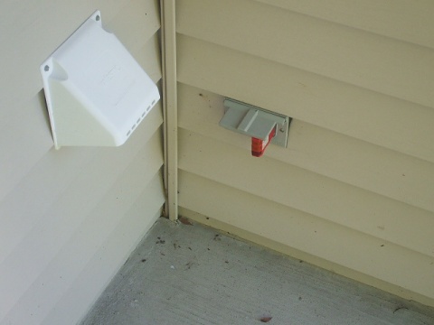

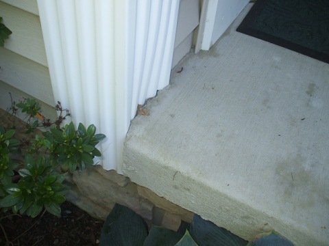

Concrete Porch abutting siding
Moisture will find its way between concrete and siding. Because lack of air flow will prevent it from evaporating, moisture levels will eventually activate mold fungus, exterior sheathing and studs will begin to decay and mold spore concentrations in indoor air will rise some.
If it were my house I’d slot the siding and get some flashing in there, sealed to the concrete.
I’d write it up as a potential decay and mold problem created by poor construction practices.

Well, marcel, you can presume whatever you want, but I am a 30 year homebuilder, code official and inspector and know what I am talking about.
No one has YET answered just HOW this concrete porch butted up against the vinyl siding will or has caused any problems.
HOW? WHY?
We have the original investigating inspector noting ‘efflorescence’ in the foundation wall below the porch, but admits the porch and deck is covered by a roof and not noramlly subjected to water infiltration…
So how is ‘rain’ or water running off the porch the problem?
It likely isn’t.
Sounds more like a bad damproofing/waterproofing of the foundation issue to me.
And sounds like you’d have the same efflorescence problem if the concrete porch was there butted up against the vinyl siding or if the concrete proch or any porch existed at all.
Start actually THINKING about this problem, people, and stop trying to just knee-jerk response without considering all the facts!
And blaming builders or code officials when the home inspector is making claims that simply don’t add up…
sheesh…

Is there a moisture barrier under the siding?

It is #5 in the red!
IRC
R613.5.1 Anchoring requirements. Window and glass
door assemblies shall be anchored in accordance with the
published manufacturer.s recommendations to achieve the
design pressure specified. Substitute anchoring systems
used for substrates not specified by the fenestration
manufacturer shall provide equal or greater anchoring per-
formance asdemonstrated by accepted engineering practice.
R703.1 General. Exterior walls shall provide the building
with a weather-resistant exterior wall envelope. The exterior
wall envelope shall include flashing as described in Section
R703.8. The exterior wall envelope shall be designed and
constructed in such a manner as to prevent the accumulation
of water within the wall assembly by providing a water-resis-
tive barrier behind the exterior veneer as required by Section
R703.2.
R703.2 Weather-resistant sheathing paper. Asphalt-satu-
rated felt free from holes and breaks,weighing not less than 14
pounds per 100 square feet (0.683 kg/m2) and complyingwith
ASTM D 226 or other approved weather-resistant material
shall be applied over studs or sheathing of all exterior walls as
required by Table R703.4. Such felt or material shall be ap-
plied horizontally, with the upper layer lapped over the lower
layer not less than 2 inches (51 mm). Where joints occur, felt
shall be lapped not less than 6 inches (152 mm).
Exception: Such felt or material is permitted to be omitted
in the following situations:
  1. In detached accessory buildings.
  2. Under panel siding with shiplap joints or battens.
  3. Under exterior wall finish materials as permitted in
    Table R703.4.
  4. Under paperbacked stucco lath.
R703.8 Flashing.Approved corrosion-resistive flashing shall
be provided in the exterior wall envelope in such a manner as
to prevent entry of water into the wall cavity or penetration of
water to the building structural framing components. The
flashing shall extend to the surface of the exterior wall finish
and shall be installed to prevent water from reentering the ex-
terior wall envelope. Approved corrosion-resistant flashings
shall be installed at all of the following locations:
  1. At top of all exterior window and door openings in such
    a manner as to be leakproof, except that self-flashing
    windows having a continuous lap of not less than11/8
    inches (28 mm) over the sheathing material around the
    perimeter of the opening, including corners, do not re-
    quire additional flashing; jamb flashing may also be
    omitted when specifically approved by the building of-
    ficial.
  2. At the intersection of chimneys or other masonry
    constructionwith frameor stuccowalls,with projecting
    lips on both sides under stucco copings.
  3. Under and at the ends of masonry, wood or metal cop-
    ings and sills.
  4. Continuously above all projecting wood trim.
  5. Where exterior porches, decks or stairs attach to a wall
    or floor assembly of wood-frame construction.
  6. At wall and roof intersections.
  7. At built-in gutters.

Michael D Thomas: …for starters that situation is a prescription for creating massivetermite infestation before damage is discovered.
Larry Kage: Typically, there is OSB type sheathing behind the siding with white wood framing and these will rot quickly with moisture running down the crack between the concrete and siding.
Me: Moisture will find its way between concrete and siding. Because lack of air flow will prevent it from evaporating, moisture levels will eventually activate mold fungus, wood wall assembly members will begin to decay and mold spore concentrations in indoor air will rise some.
Thanks, Kenton. :wink:
I did find 2 more pictures, I knew they were somewhere.
Steve
What the hell were they thinking when they poured those areas?
