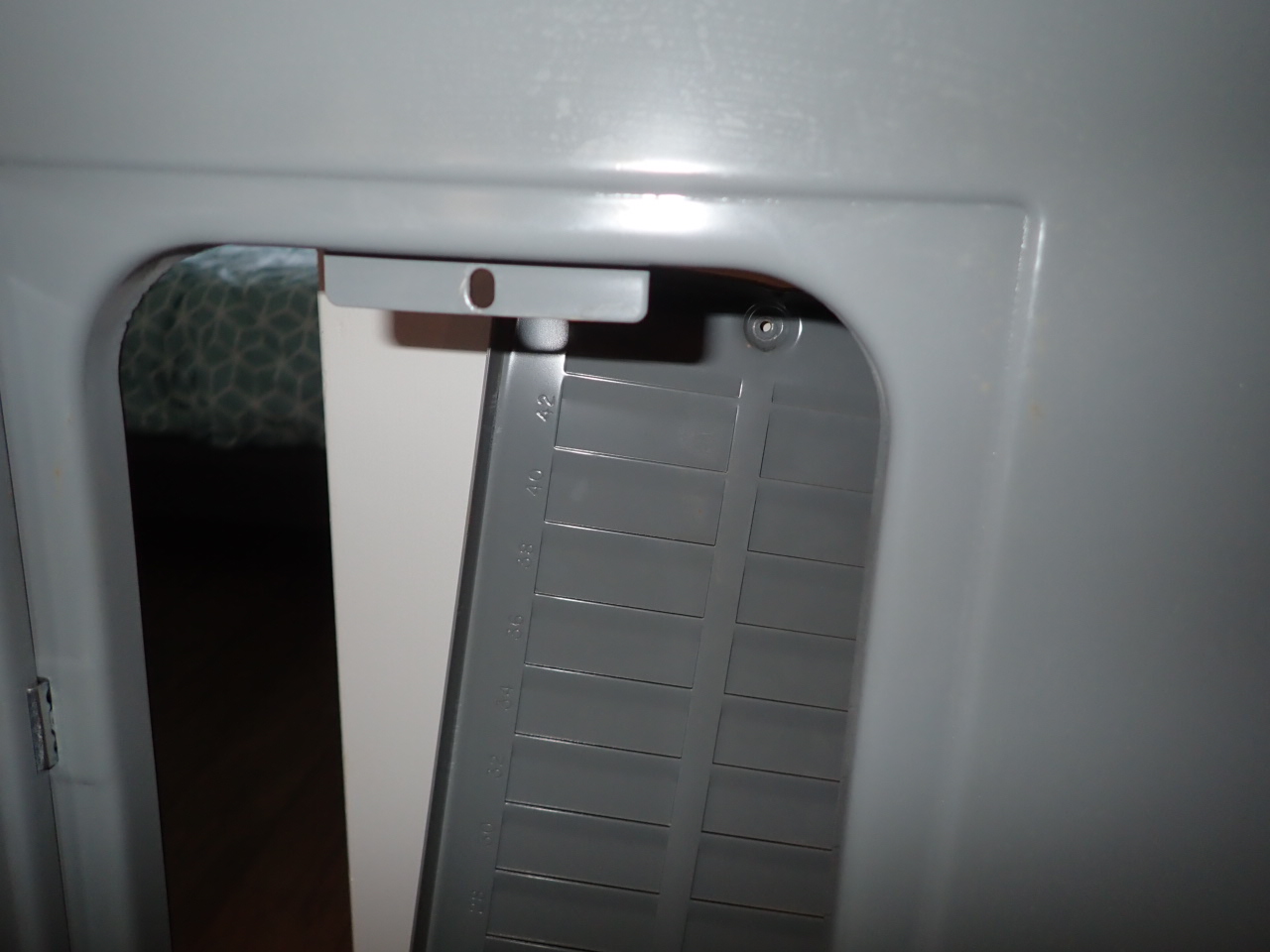

When I removed the cover it almost fell back into the panel. Top screw was missing.
Inner cover
Got it, thanks.
A potion of the pin mechanism connecting the Interior Trim to the Flush Cover is missing…
Deadfront…
That’s exactly what it’s called around here, the “interior trim”. On commercial panels you have the outer cover with the hinged door and the separate and separately fastened interior trim that surrounds the circuit breakers.
This panel is a load center that doesn’t have a separately attached inner panel. Someone turned the adjustment screw out too far and it came lose.
“IF” you would have seen this before you removed the cover - you should have stopped and called it out as a defect.
The panel should be de-energized before removing this cover.

At the risk of seeming to be pedantic I will point out that the US National Electrical Code does not have a definition for a “Load Center.” That particular panelboard is not fitted with a Dead Front cover that is not part of the cover. The definition of a dead front describes an outcome and not a particular style of construction. In common usage in the electrical industry a dead front is a cover over the energized parts of a panelboard, switchboard… that is still in place once the cover is removed. The US National Electric Code (NEC) defines Dead Front as:
“Dead Front. Without live parts exposed to a person on the operating side of the equipment.”
How the equipment designer achieves that outcome is not withing the scope of the NEC. For Home Inspectors I would think that it would be important to avoid the undefined terms that are common in any craft. If the language used has no well excepted definition would that not expose your report to attack?
I just call what the OP posted as an inner (dead front) cover.
But it’s not what electricians mean when they talk about a dead front. In the craft a dead front is a completely separate interior piece that continues to cover the breaker terminals even after the outer cover has been removed. What the OP showed in the photograph was an outer cover that is fitted with a self depth setting trim. If one of the adjustment studs had not been broken it would have come off cleanly once the cover screws are removed. Real Dead Fronts are separately fastened to mounts inside the panel cabinet. To get at the terminals of the breakers you have to remove the cover and then unscrew and remove the interior terminal shield that is commonly called a dead front.
