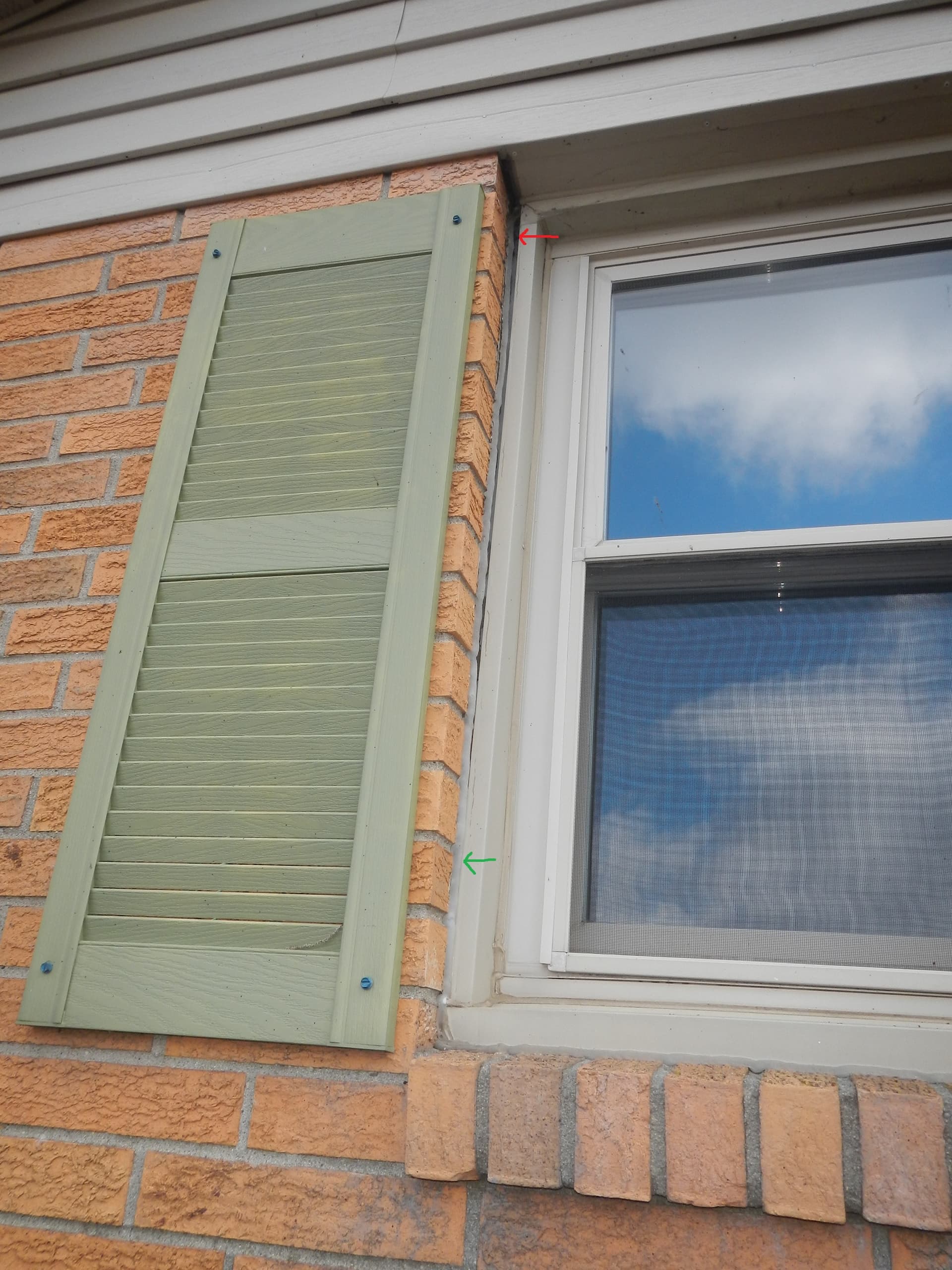

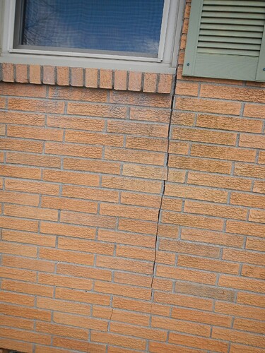

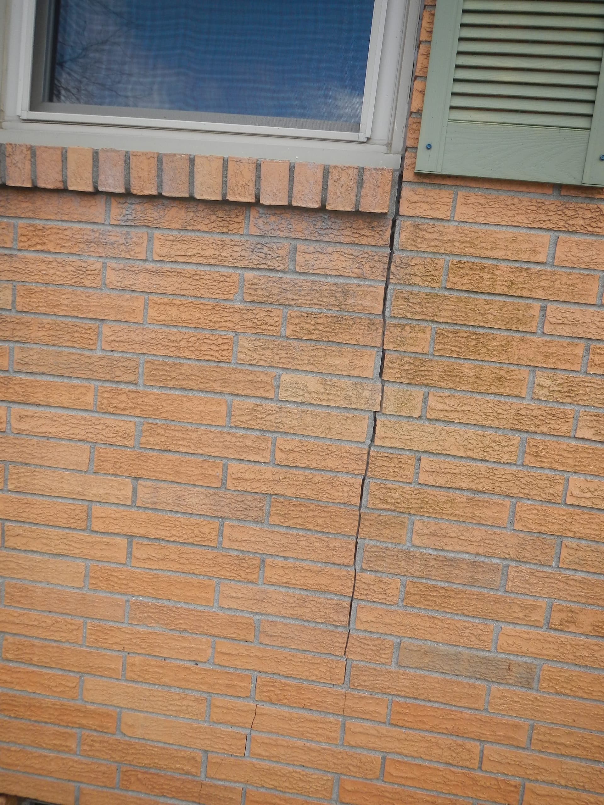

This home has a brick veneer crack on the left side that is ¼ inch wide at the top but 1/16 inch lower down. Then the crack shifts over and disappears. I know brick veneer isn’t structural, I just have some concerns that the footer has dropped slightly (see below). The floor inside is carpeted. The window above the crack functions smoothly but there is a tapered crack in the caulk on the back side.

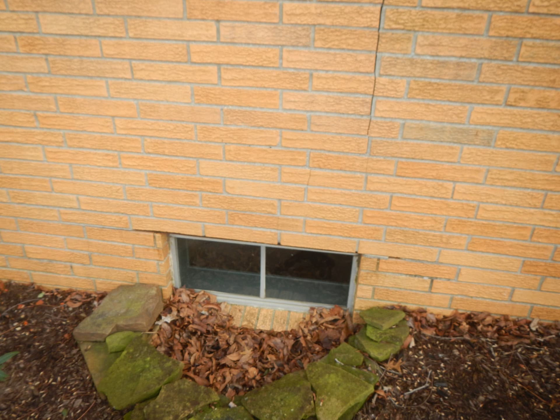

There is a much smaller brick veneer crack on the right side of the home that is the same distance from the corner. This is why I’m concerned. On this side, there is a basement garage and there are no corresponding cracks in the floor.

Possibly the metal lintel over the basement window has corroded, expanded, and caused the cracking. I’ve seen this condition many times, but I don’t ever recall seeing it on a basement window.
Of course another possibility would be settlement on one end or the other.
Thanks Kevin, I looked at and probed the lintel with an awl, it has surface rust but isn’t corroded.
The brick veneer is in contact with the soil. Around here, expansive and/or freezing soil heaves up, pushing on the brick… Yada yada yada…

Keep in mind that on a standard foundation with a basement, the basement floor and garage floor would likely be free floating and may not have cracking in the event the foundation itself has settled, especially if the slabs have reinforcement such as rebar.
Were you able to see the foundation wall itself in the areas where the cracking brick was located?
I think minor settling. The crack indicates that the mortar was mixed too strong. The stress broke the brick instead of staying in the weaker mortar and mortar joints. No going back to remix the mortar.
Unless the foundation shows something worse, it looks like a cosmetic repair.
Generally, cracks that are wider at the top than the bottom indicate settling.
I find that many/most houses with brick veneer do not have a thermal expansion/contraction joint installed. Brick work is supposed to have a vertical expansion joint every 25 feet at a minimum. If you don’t have an expansion joint, a vertical crack typically forms somewhere in the middle of the wall often at the corner of a penetration (like a window). If there isn’t some degree of unlevelness at the interior associated with the crack. And if they don’t have any thermal expansion joints installed in the brick veneer… then I would call this a thermal expansion crack… and not related to a foundation settlement problem.

Something is moving. I would recommend a structural engineer.
