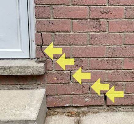

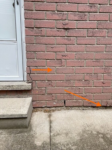

Based on the picture alone, it appears to be settlement from the lack of support under the base bricks to the right. But one can only guess from the pictures.
I would not get all excited based on the photo’s. Hire a mason to come out to evaluate and repair as needed. Be prepared, the slab may be settling which will add cost, but is still not dramatic.

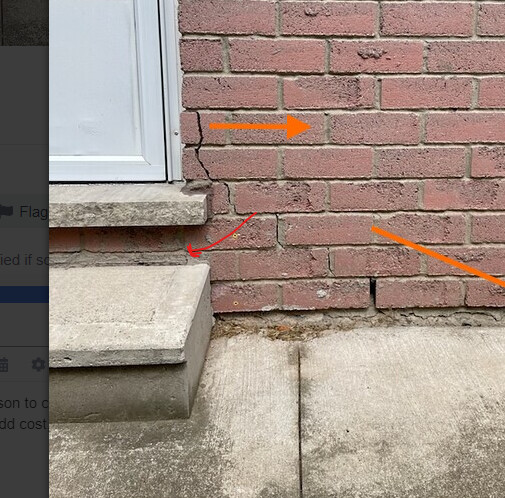

See that old step grout line?

Based on the info that you provided, I would recommend hiring a geo-technical (soils) engineer to evaluate the foundation and make recommendations for repairs.
The “V” shape of the crack, wider at the top than the bottom, is telling you that it is foundation movement. Because you (they) did not see cracks on the inside of the house is probably because the brick is a veneer (non-structural). The true question IMO is this an old crack due to a one-time settlement after construction or a new crack indicating an on-going problem that could get worse? Look for clues. For instance, is the door threshold and step to the left flat and level? Old step versus new step (what Brian was pointing out)? Any telltale cracks in the sidewalk? And, so forth.
