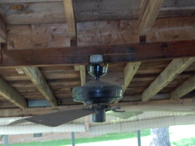

Mine from today.
that looks just like my father inlaws screen porch. were you in Derry??? don’t steel my clients:mad: :mrgreen: :wink:
From the picture, unless it is an illusion, it appears that a check crack has already started at the base of the electrical box.
But don’ worry, they added solid blocking to beef it up.
