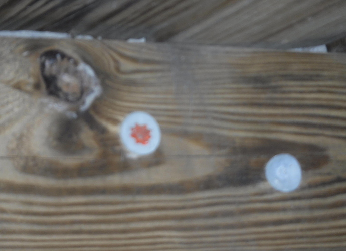

The deck ledger board in this photo is a 2x6. It is also attached to the foundation with a “Hilti Gun” nails.

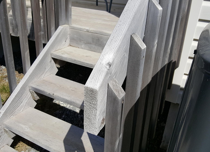

Deck in the picture shows a lot of weathering and decay. What can not be seen is the one side of deck is actually sitting on grade and was very soft to walk on. In picture you can see the sagging that is happening to the right side of the steps. Railing is also improperly secured and does wobble when grasped.

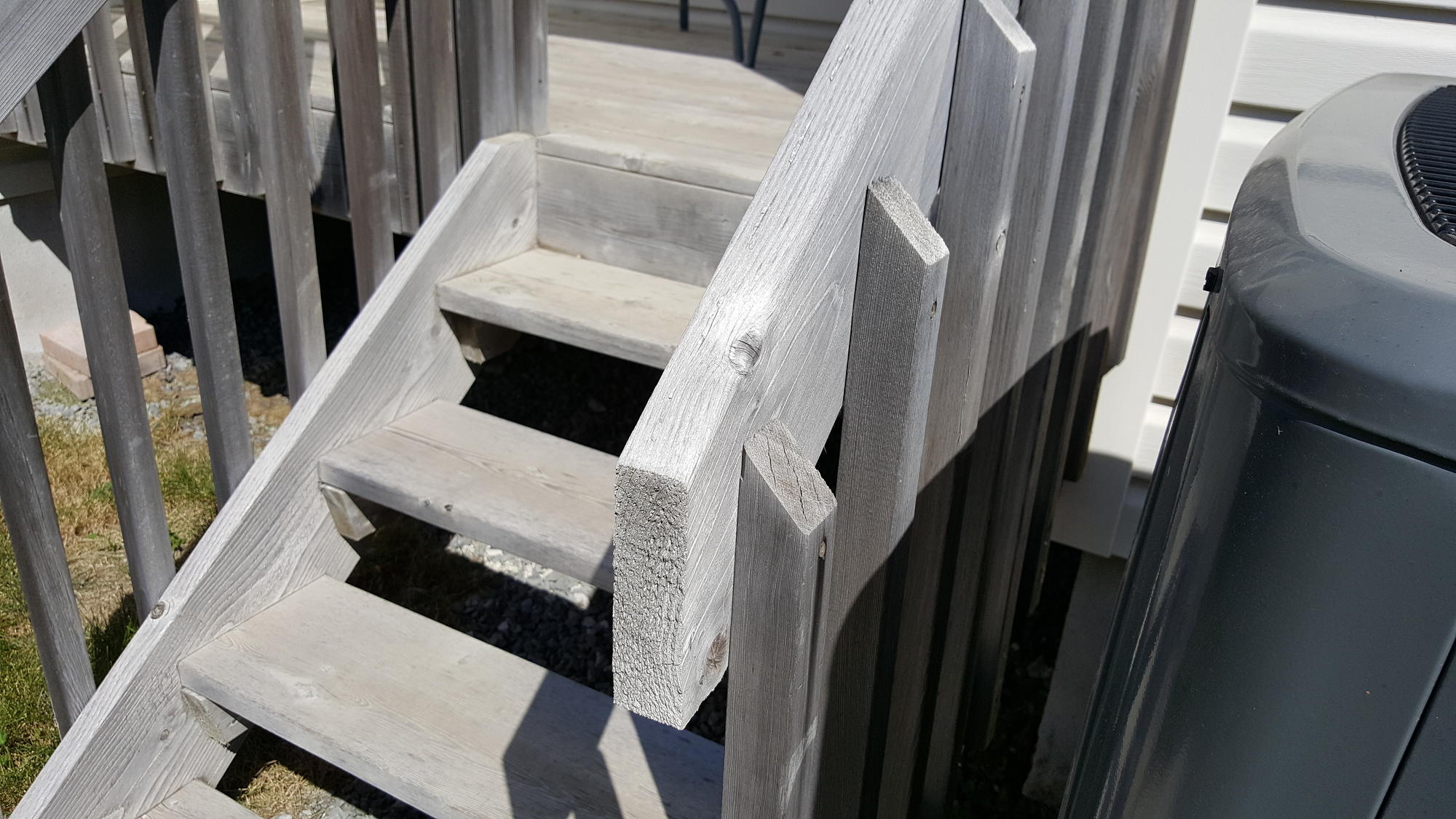

here is a deck that was repaired and resurfaced. The steps leading up to deck have been replaced. Steps are only 3 treads and deck finished grade is less than 30" so handrails not required. However, steps appear poorly built and improperly secured to deck with a few toenails. Top step is different height from others and poses a trip hazard.
So this course on deck inspections led me to a poorly built set of steps leading up to a deck on my brother in laws house. the steps appear poorly built and improperly secured to deck with a few toenails. The top step is a different height from the other step and poses a trip hazard.

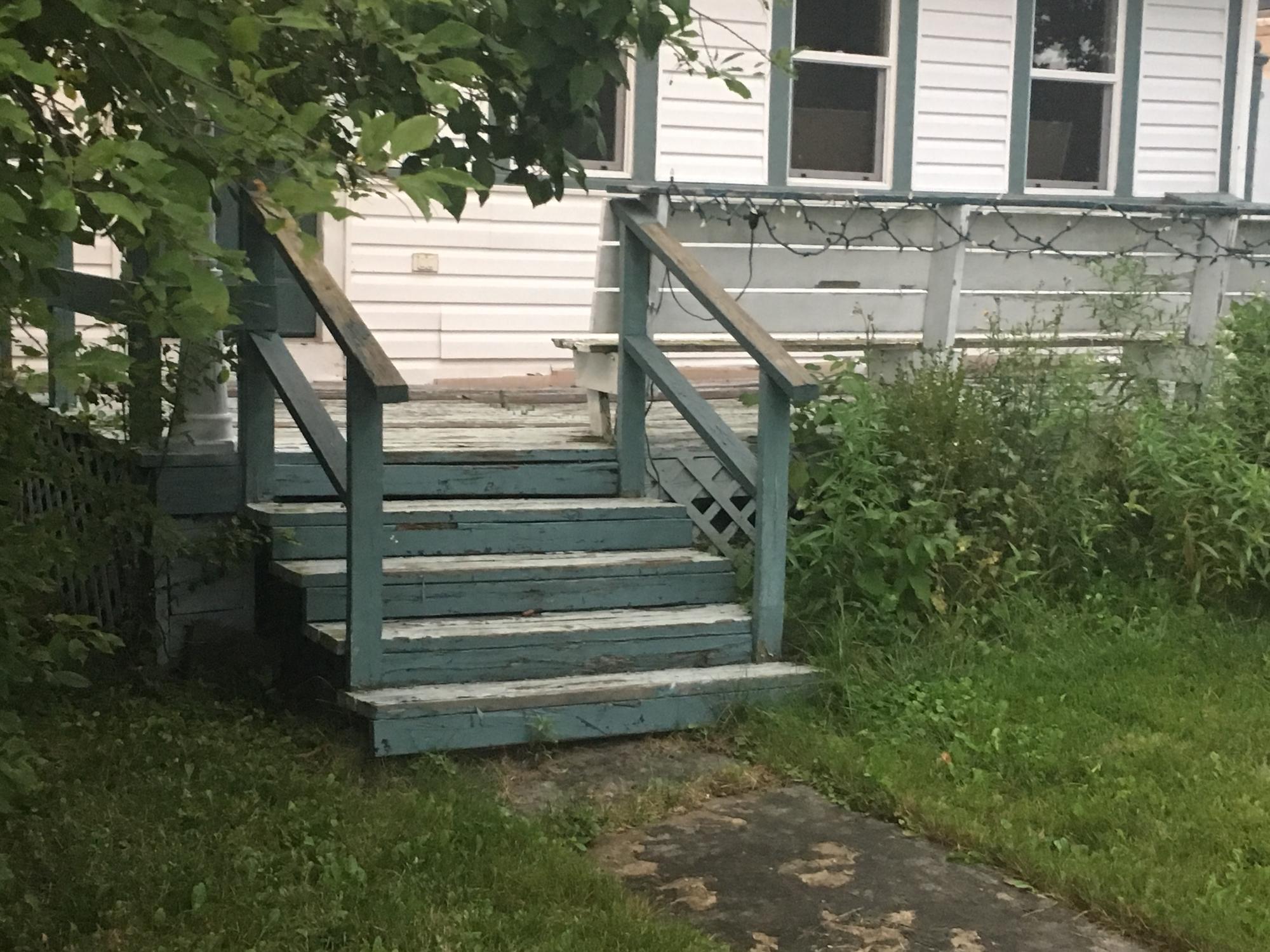

This is a photo of the deck that was improperly built. The steps are of unequal heights the average difference of the step heights is one inch. This is a trip hazard. I recommend contacting a professional contractor to further inspect and repair prior the closing of the sale.

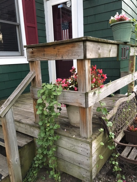

The deck is on the front of the home. Its railing is not safe for children. it needs to have balusters installed with no more than 4" of space between each baluster.
