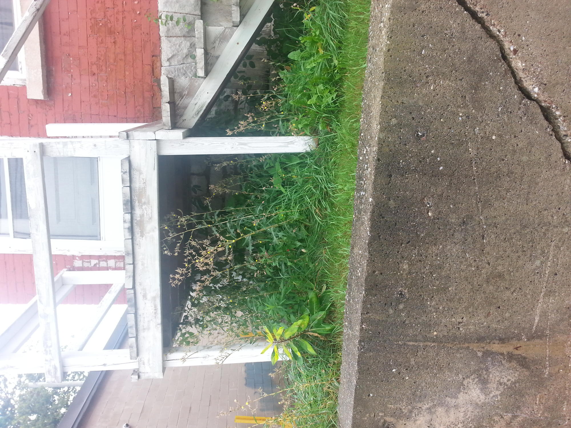

Deck on front of house old. Built when the house was built, 1960’s. Is peeling paint, and beginning to rot in addition to being built badly out of square. In the picture you can see the east post (closest to camera) is out of position with the far post buy 2.5”. If you look closely to the front plate you can see a distinct curve in it. Top plate of railing has been replaced. It is square but looks bad because deck is not. Recommend replacing entire deck. Maybe redesign to a single level. 2 level deck is a tripping hazard right by front door.

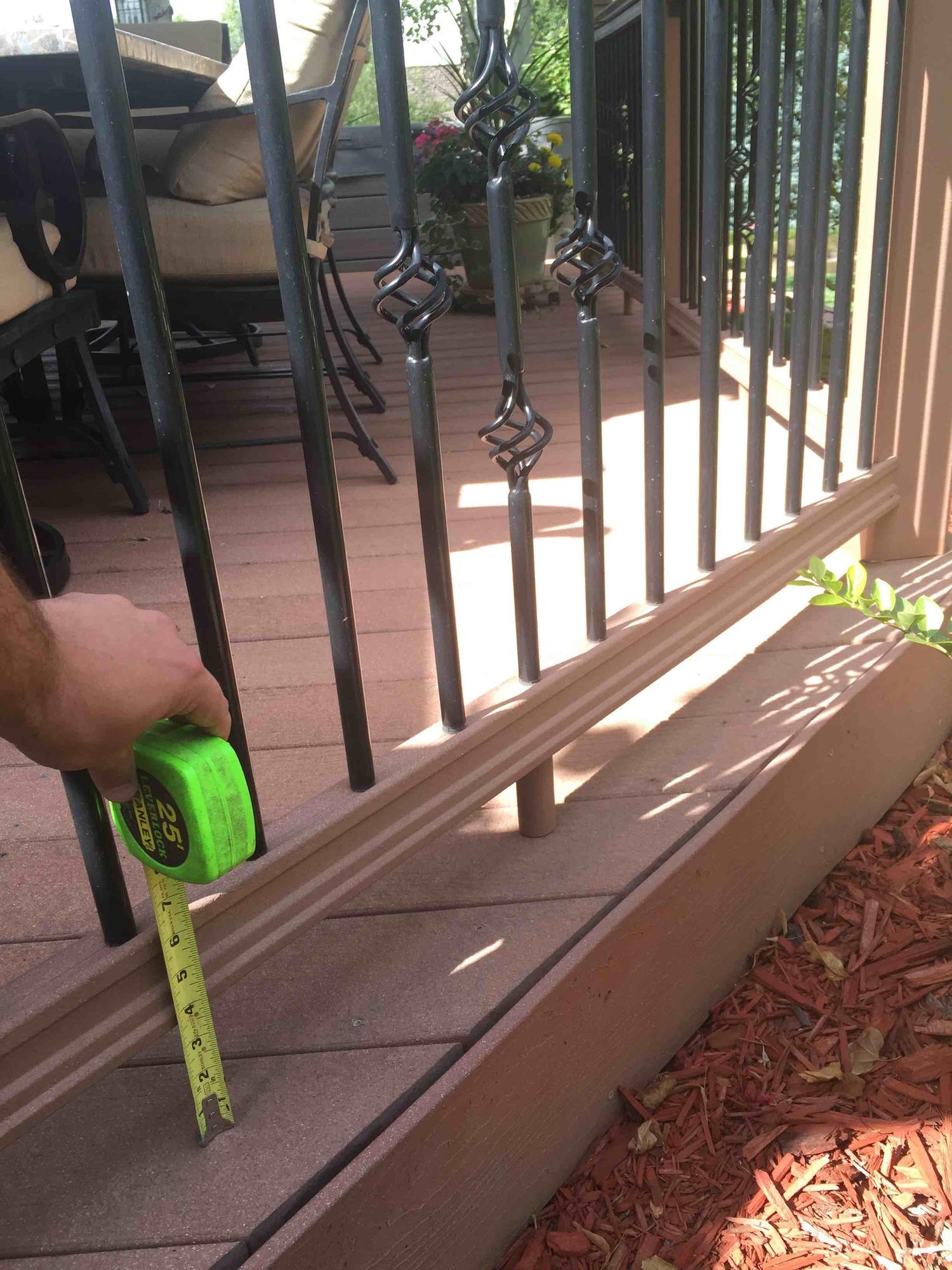

Deck of home being inspected is in good condition. The deck is made up of trex. the baluster is within 4" and is safe. The guardrail is a safe height as well within 4"

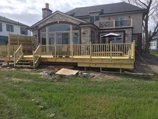

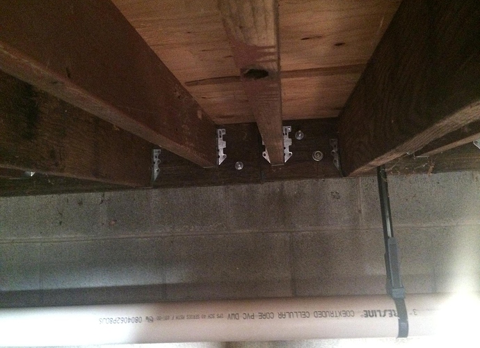

This image shows a deck we constructed. the girders are hung on the posts with 1/2 galvanized through bolts. The deck structure is then built on the girders. The posts extend through the deck to support a trellis.

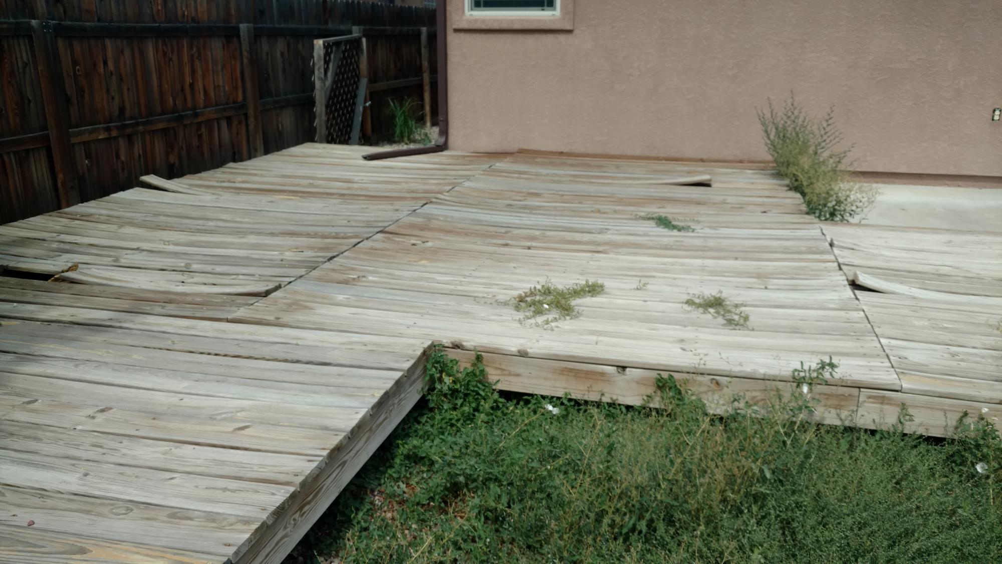

This is from an inspection that I did earlier today, just happened to coincide with the course work. Everything about this deck was wrong or broken. The first thing I noticed was the decking or planking, what used to be very nice hardwood planks have now turned into scrap wood. All of the boards were warped and deformed. The boards weren’t staggered, and many of them had been cut down and are now only spanning 2 or 3 joists. The rim joists were sagging, and had spans that were obviously too great for the framing materials and/ or design. The posts were untreated 4x4’s that were sunk into the ground, to an unknown depth. The whole thing needs to be ripped out and rebuilt.

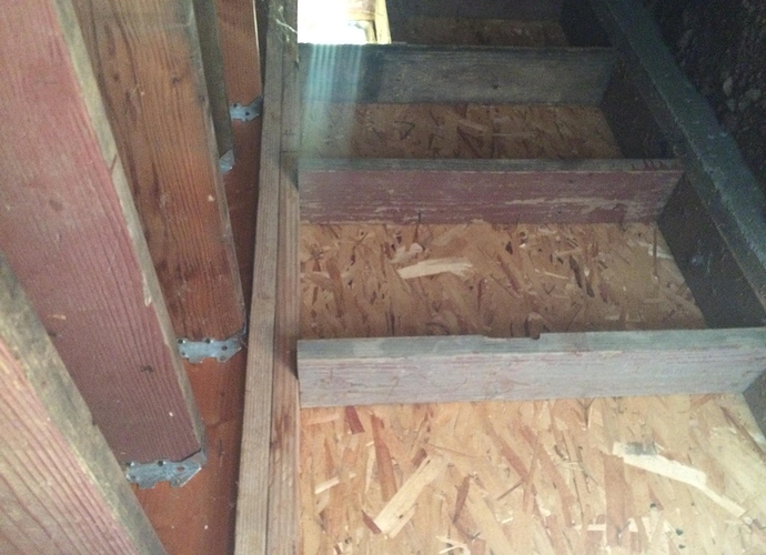

This deck is a raised concrete slab supported by a joist and ledger system. There is a perimeter concrete footing and wall supporting the deck. The deck was waterproofed between the deck sheeting and the concrete using a PVC or single ply roofing material and flashing on both sides of the deck are done correctly and are in good condition.
