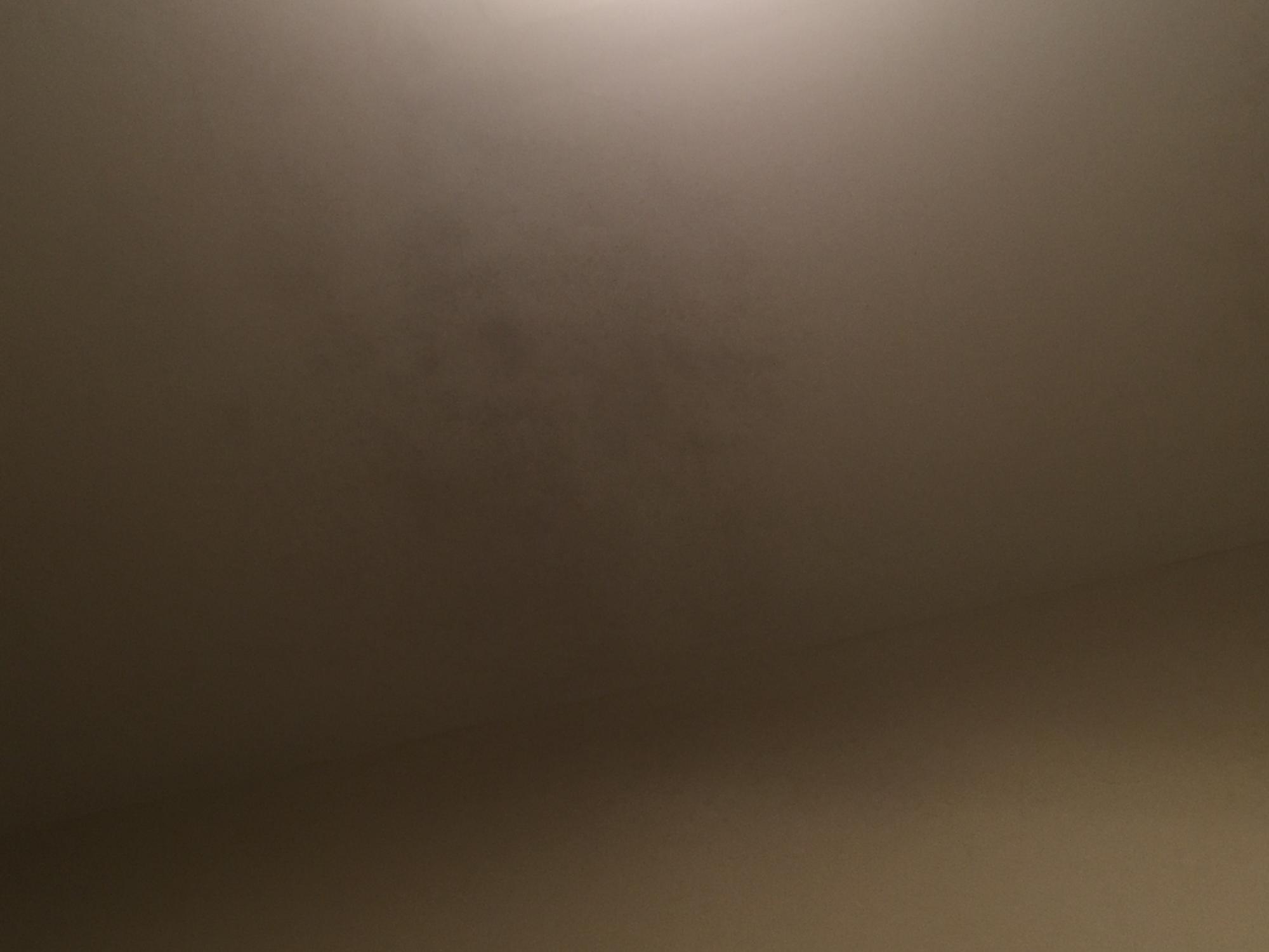

This is a picture of a bathroom ceiling…just outside of theshower and above the toilet. Althoughthe lighting is a little fuzzy, there is noticeable discoloration on both theupper part of the wall and on the ceiling. As there is a musty odor in the bathroom and there is a distinguishablepattern to the discoloration, this appears to be mold. Since this course focuses on report writing,I would note this in the report as follows: Discoloration noted on upper wallsand ceiling of guest bathroom. Thisdiscoloration appears to have the characteristics of fungal growth. I would recommend a follow-up with a mold professionalto have this tested so that it can be properly tested, identified andremediated.

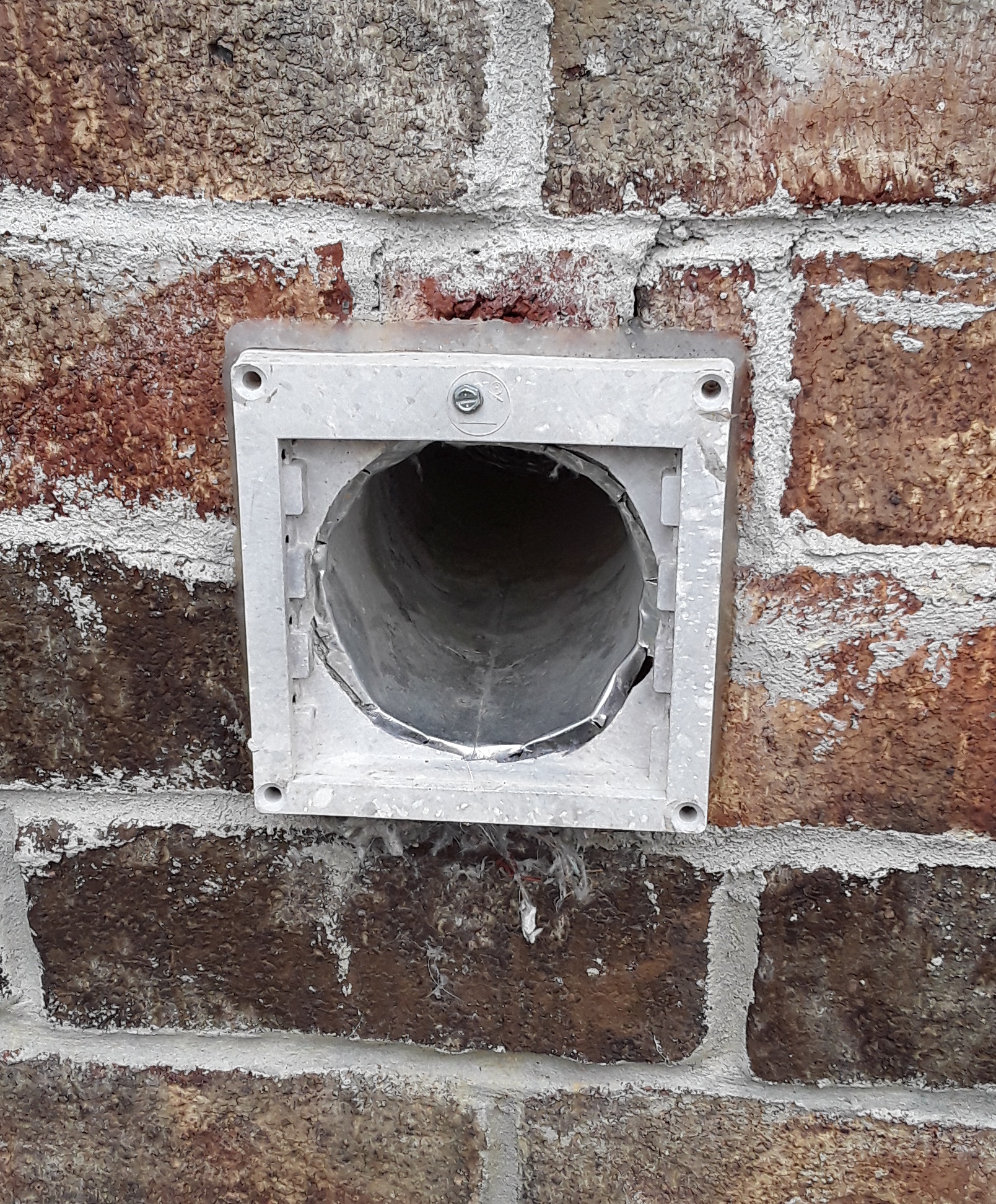

This is a picture of the dryer vent termination located on the back northeast corner of the house. This could allow pest and weather intrusion into the interior of the house. Recommend the vent termination be replaced with one that has an operable damper.
