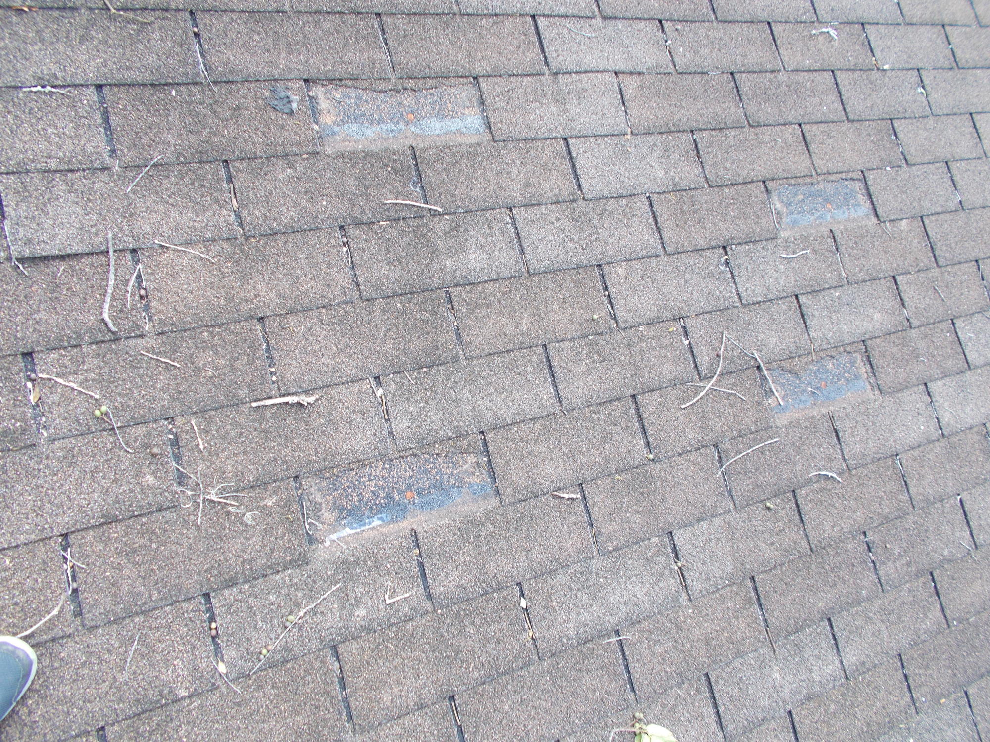

Defect: On the North slope of the dwelling there were multiple shingles missing. Water intrusion is very likely around this area, which can lead to damage to the roof decking, and the structure around it and below it. Recommend repair as soon as possible by a licensed, qualified roofing contractor.
