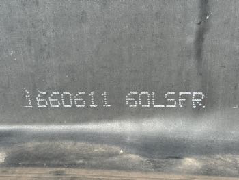

I Inspected this roof on a townhome that was built in 2006.
The roof did have some bathroom vents terminating over it. One of those vents may have been used as a roof vent.

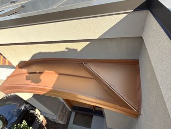

What do you call small roofs sticking out of the side of the home such as these with the metal copper penny roof covering? Sometimes I see these types of smaller roofs sticking out of the wall with gable and shed styles. Seems like there’s a more accurate description of their architectural style that I need to learn. I called these ones out for not having kickout diverter flashings.

That’s why I asked about it. I’m not entirely certain what the standards are for venting a roof with an EPDM roof covering. It did feel like there was insulation underneath the EPDM roof covering.
What other pictures would help you to answer my question?
This roof had bathroom vents, a flue vent, two gutters, and four plumbing vent stacks.

I would refer to the roofs or architectural designs the front of the home, the fenestrations as; Arched Copper covered front door and garage door awning roofs.

How do you know that this roof has ISO board insulated panels? I know that there was some type of insulation underneath the EPDM because I could feel it squishing underneath my feet. I suppose that you could also draw that inference from the fastening pattern that’s visible on the EPDM roof covering.
I did read through a lot of that manual where you got the screenshot from.
The roof contour to the drain is a primary indicator. The ISO board will be stacked and contoured to control water flow. And the squishy feeling may be another indicator. ISO board are thick foam panels. I know immediately when I step on these roofs. Also, the era built (2006). What I describe is typical modern construction.

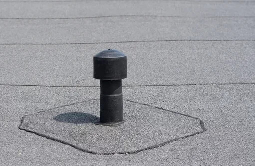

When the insulation is not as I described, you may find this membrane rolled directly over the roof decking with no insulation panels. (Common with old buildings). In this case, you will find different forms of roof ventilation. Here is an example of an old low-slope roof that is ventilated. Edit. It likely has a low plenum or crawl between the ceiling and the decking. Insulation may be present there.
Google flat roof vents. You may see them in the wild. Here is one.
