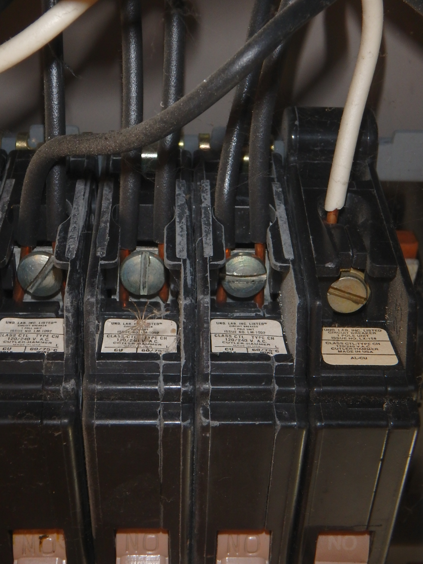

IIRC, that style of older C-H did allow two conductors, one under each side of the screw. I will check the truck to see if I have one that old. You can tell it is older by the metal feet for the mounting rail.
