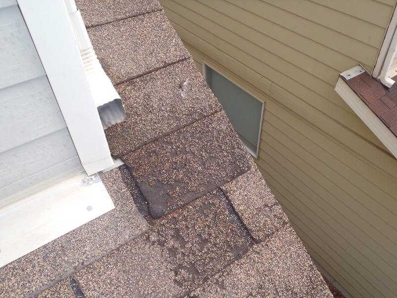

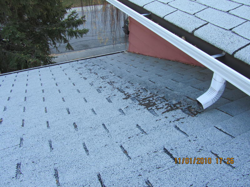

I call out this condition every time I see it which seems to be on virtually every house! Does anyone have a good graphic / illustration I can use in my reports?

Thanks guys, I always include a photo of the actual condition as I observed it however I would like a good illustration of the problem and how it can be remedied. I do not want to include an actual photograph from a different house of the eventual deterioration that will be caused nor how it should look after being corrected. I would prefer a black and white illustration so there is no confusion.
I search Google images as described but have yet to find a good illustration of roof cladding deterioration from concentrated water discharge, or downspout extensions leading from an upper roof to a lower roof eaves trough or down to grade. The Carson Dunlop one is the closest but dormers don’t concern me much as there is not enough roof area to be worried about, I’m looking for split / bi-levels with larger upper roof surfaces.
I am sure if you ask Nick! He will send you one and then put it on the Nachi Library. Here is one for now.
This one is diverting from the sidewalk.
It’s a non-issue in my view. Never seen a worn spot on shingles beneath a downspout, unless the entire roof is shot.

[http://www.nachi.org/forum/attachments/f16/49238d1319867122t-downspout-discharge-onto-roof-illustration-img_6695.jpg](http://www.nachi.org/forum/attachments/f16/49238d1319867122-downspout-discharge-onto-roof-illustration-img_6695.jpg) [http://www.nachi.org/forum/attachments/f16/49239d1319867269t-downspout-discharge-onto-roof-illustration-p5200018.jpg](http://www.nachi.org/forum/attachments/f16/49239d1319867269-downspout-discharge-onto-roof-illustration-p5200018.jpg)
]You have now, 3 different houses ![]()
