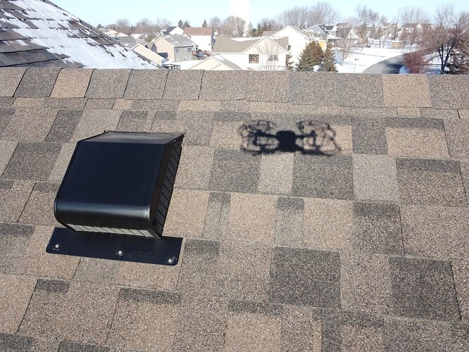

Here’s a good example of a recent case where a drone was invaluable. Most of this roof is covered in frost. The slippery conditions combined with the variable terrain and building features around the home made it quite difficult to even get a ladder at most of the eves. The drone allowed for a fairly thorough inspection in a swift manner without breaking a sweat. Probably took me 15 minutes onsite to get 200+ pictures of this roof for review back at the office. Pictures are straight off the drone, no editing. And yes, I use the prop guards, because I haven’t had a reason to take them off, lol. I ordered a custom case off ebay that allows me to store the drone with the guards on, which is nice.
