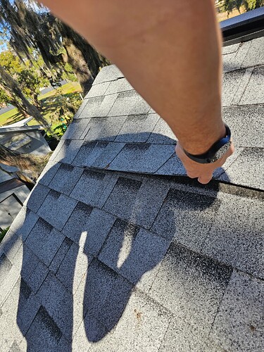

Speaking of which, this was yesterdays inspection. Brand new roof, and probably 1/3 of the shingles have the cellophane stuck to the tar strip.

It doesn’t have to be removed, FYI.
From the factory:
That cellophane strip normally sticks to the top of the underlaying shingle in the packet. When the shingle is installed, that cellophane strip is totally out of the way, at the top of the shingle. In this case, it stuck to the tar of the overlaying shingle in the packet. As a result, it prevents the tar from activating in the sun and sticking to the shingle below after being installed on the roof. This is a defect making the shingles subject to wind damage.

Like Michael stated, these strips stuck to the tar strip, instead of sticking to the top of the shingle, where they should have stayed. So now, it prevents the tar from melting. lazy roofers didnt notice it, or didnt care…
As soon as a hurricane comes around, those shingles are gone.
I see this a few times a year. I actually pointed this out on a brand new home for a pre-closing inspection about a week before hurricane Ian, and they didnt fix it. Buyer told me they ended up replacing the entire roof. Makes me wonder how many other homes in that neighborhood had the same problem

But that video doesnt address this problem…
That is, when the cellophane was either installed improperly, or it stuck to the tar rather than stay where it was designed to stay.
it should never prevent the tar from actually bonding the shingles together
the celophane disolves with water contact over a short period of time and there is no reason to remove the strips, I can explain it to You but I cant understand it for You…
