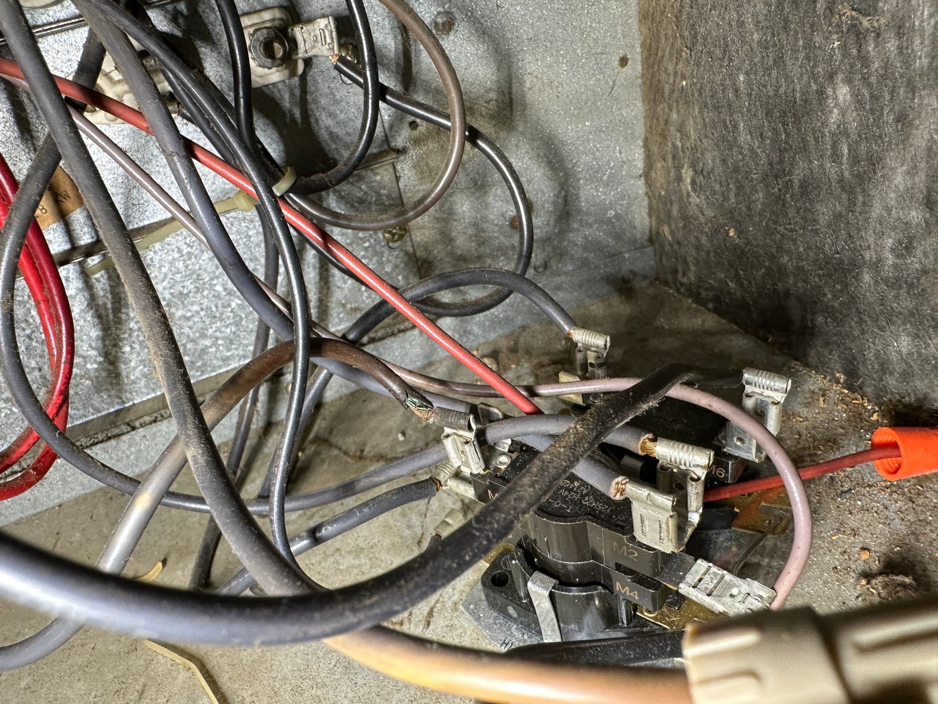

I recommend inspectors get the training necessary to be comfortable inspecting electric furnace wiring. The three attached pictures from today’s inspection show doubled-tapped wiring and scorched wiring attached to a heating element. This type of inspection doesn’t require sticking your hand inside, however I do use an amp meter to verify all the heating elements are working.
So what did the double tap go to? I assume the original furnace was designed for single tap.
Bryce, it went to the dryer outlet.
