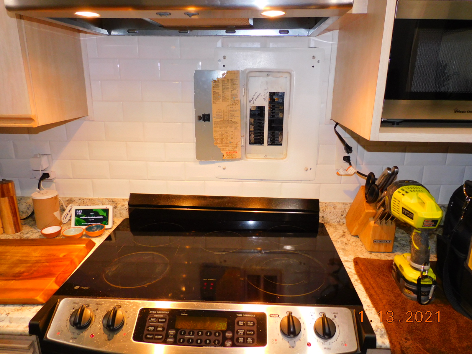

Electric Panel on todays job
Obviously this panel violates the NEC 3 foot front, 6 foot height and 30 inch wide clearance requirements.
Question is… Are there any specific prohibitions regarding its proximity to the Range itself, other than it being a really bad idea with the whole grease and steam potential? Or does the standards on clearance cover this .
Thank You for your thoughts

Don’t really need anything other that the clearance requirements you have stated. That is completely wrong, but, having said that, nobody is going to correct it. Make sure to report but just move on.

I appreciate your feedback Robert. “Vapor Diffusion” is more of an Impact of the Defect than a Codified description . And much more of a pretentious Narrative than I am comfortable with in my Report.

Additionally, the heat generated by the stove is likely to make the plastic breakers brittle and possibly expand and contract making connections unreliable and dangerous.
