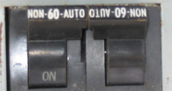

This was at the Svc Disc of a Package AC Sys

Originally Posted By: hgordon This post was automatically imported from our archived forum.
Im in the middle of sriting this report. What type of a breaker is this?

Originally Posted By: tallen This post was automatically imported from our archived forum.
Best I can say from the pic it is a double poll 60 siemens . Hopefully Joe Tedesco will show up.

Originally Posted By: jtedesco This post was automatically imported from our archived forum.
A non automatic circuit breaker is a switch, and will be better understood if you do a search on Google for a “non automatic circuit breaker”
Quote:
Non-automatic circuit breaker ? A circuit breaker which has no automatic thermal overload trip
element but does have a magnetic trip element for short-circuit/fault protection. Short-circuit and overload
protection must be provided by an upstream overcurrent device.
Yeah Joe…but what does that mean to my client?
Gordon:
I believe that the second sentence in the definition help us to understand: "Short-circuit and overload protection must be provided by an upstream overcurrent device." This means that there must be another overcurrect device ahead of this circuit
So heres my question…what good is it, other than to shut off service to the unit?
And to make matters worse, look what's upstream:
I say it is simple.
Recommend a licensed Sparky and go on your way.
Wait are you saying that 60 is the main for that panel????
Does not matter report is the same Sparkey!
I didn't see this until now.
The disconnecting means at the AC unit will satisfy the ready access to it, but now I smell a fish!
First thing is to look at the label on the unit to see what it says related to: "Maximum Fuse Size" or "Maximum Fuse Size or HACR Circuit Breaker"
The panelboard that you show, does it have an overcurrent device that is used to protect the branch circuit to the unit?
If so I would check to see if it is a HACR CB like I mentioned above if on the label.
Otherwise it is a HOT POTATO and you should do the typical recommendation to cover your a$% .
Joe, Mfg Recommended Max CB is 40Amps
Do I state Over Fusing AT Svc Disc taking into consideration now the issue of the Non-automatic circuit breaker?
A/C disconnect is over fused recommend evaluation by a licensed electrician before the close of escrow.

Originally Posted By: roconnor This post was automatically imported from our archived forum.
Harvey,
If I understand you correctly that 60A switch is at the unit, which is not over-fused and doesn't need to be an auto breaker since it is just being used to shut off power to the unit for servicing (disconnect or lock-out required by model codes). Then there should be a 40A max standard breaker at the panel to protect the wires and unit. If that is the case I don't see a problem.
But that looks like an FPE panel, which I think is an automatic flag for further evaluation by a licensed professional.
Hope that helps ...

Originally Posted By: jpeck This post was automatically imported from our archived forum.
Harvey,
That is simply a molded case switch, just like putting in a non-fused pull out disconnect.
It offers no overcurrent protection and is there to serve only as a means of disconnect for serving the unit.
Like putting in a real heavy duty rated double pole switch (actually, not "like" that, that "is" what that is, a 60 amp rated double pole switch).
