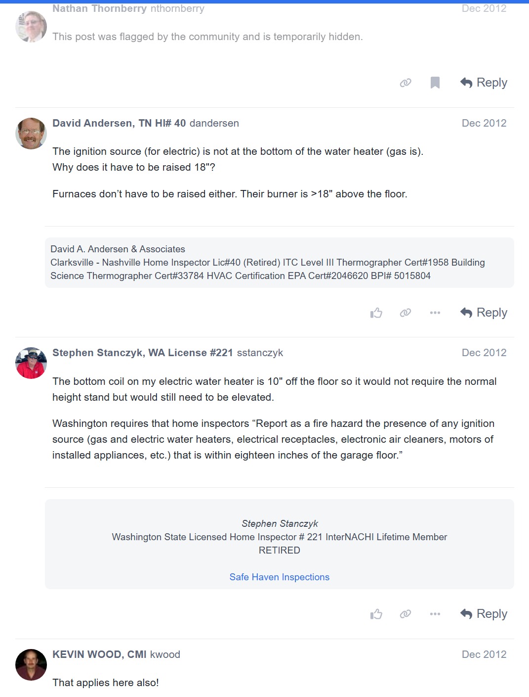

Now you are challenging the validity of the standard. This is not the audience for that. There is a requirement written specific to water heaters. I am unaware of of any specific requirement for freezers, washers, clothes dryers, etc. Do they pose less risk? I doubt it, but that is not the question.
I don’t disagree with that.
The height of the installed thermostat on an electric water heater is 14.33"from the bottom that I found.
Now seeing that I always call for a 4" maintainace pad under equipment or appliances in the garage or basement, that would meet your 18" requirement as perceived by the ICC. Would it not?

Marcel, you keep referring to the thermostat. What about the actual wire connections to the element?
What about them? If done correctly, should not be any worse then the electrical outlets or switches anyware else. Oh, I forgot, receptacles should be at 4’. :wink:
I referred to the first thing that the Code suggested, Follow the Manufactures Instructions. There is the picture minus the maintenace pad that I would recommend. :slight_smile:
Factory installation of the element wiring is usually torqued to manufacture specifications. Replacement of the element by a handyman may not meet those standards. Are you saying you have never found a loose wire on a receptacle or switch?
I am required to call out receptacles if they are below 18 inches as well. We are only speaking of the garage at this point.

Almost every manufacturer of water heaters has a disclaimer / warning regarding installation that “local codes” must be followed in regards to garage installations. It is obvious that your state, county, township, city, burg, village, cave does not. Install to your heart’s desire. :wink: :mrgreen: With the vast number of jurisdictions I cover, I am lucky that the State overrules all of them and makes it easy. Report anything under 18 inches.

Actually, I would be interested in where 18 inches is considered the line of demarcation between explosive gases and the “safety zone” comes from.

(c) Water heaters. The inspector shall:
(1) report the energy source;
(2) report the capacity of the unit(s);
(3) report as Deficient:
(A) inoperative unit(s);
(B) leaking or corroded fittings or tank(s);
(C) broken or missing parts or controls;
(D) the lack of a cold water shut-off valve;
(E) if applicable, the lack of a pan and drain system and the improper termination of the pan drain line;
(F) an unsafe location;
(G) burners, burner ignition devices or heating elements, switches, or thermostats that are not a minimum of 18 inches above the lowest garage floor elevation, unless the unit is listed for garage floor installation;
