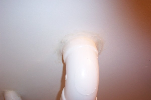

The first picture is of a mushy floor in a bathroom on the drain end of the tub…it was mushy enough to push on and have significant give…as I made my way to the lower level while this tub was draining I could hear loud drain sounds…the second picture shows the drain pipe of that tub exiting the ceiling directly underneath…and the pipe was plumbers putty heaven! It was all over the outside of the area it exited. The picture doesn’t do it justice…there wasn’t any moisture present as it drained or after it drained…but I’m wondering if the tub drain didn’t leak causing the mushy floor and this was the resulting repair?

There is a mushy area in the middle floor bathroom at the corner of the bathtub and wall near the doorway. It is unknown what is causing this problem or how old it is. There was not any moisture evident at the time of the inspection. Pic 1
The drain for this bathtub is visible in the ceiling of the bathroom directly below this bathroom. There is visible caulking around this drain that doesn’t show any moisture after draining the tub, however, this caulking doesn’t appear to be the proper repair. Recommend having it evaluated by a licensed plumber.

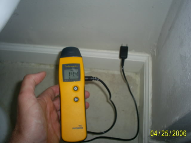

Would common sense tell you this wall is too damp?

The wall in the photo is adjacent to a shower stall where the previous HO had a leak and ‘fixed it’ prior to putting the townhome on the market. The info was in the sellers disclosure.
New HO thought maybe the drywall should have been replaced, but wasn’t. I fear (but did not express in the report) that there will be considerable mold growing in the walls behind the ‘damp wall’.
This picture is of the same wall in the other bathroom. I use a moisture meter where it’s use is warranted by my inspection, or when I learn something from the disclosure that might justify it (as in this case).

So did the meter tell you the wall had too much moisture? Or had it dried out as a result of the previous repairs?
