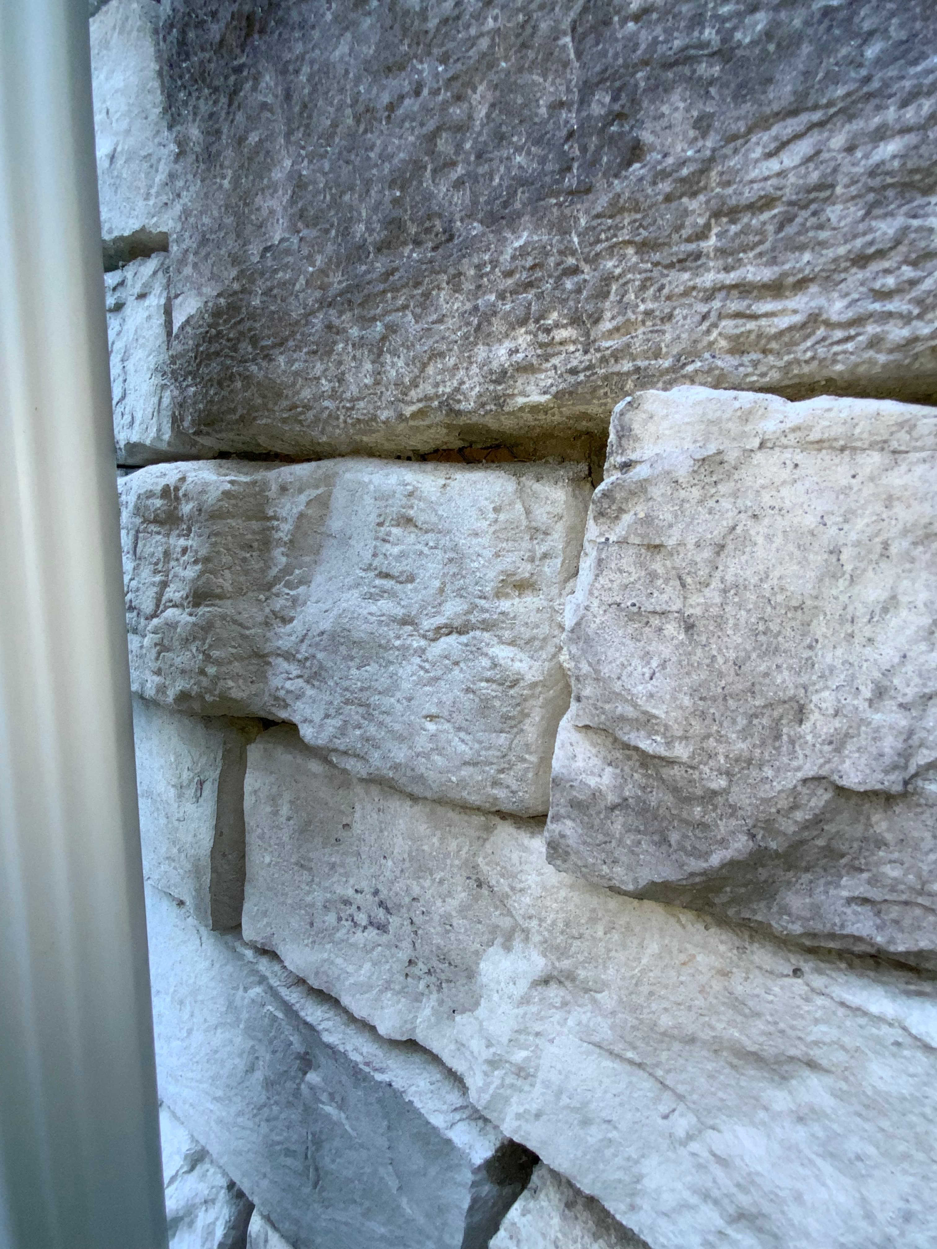

I don’t have much experience with stone veneer. At one area (hard to see in pic) I can see the metal lath between the stone. Doesn’t look like mortar was installed all the way over it. Is this a concern? Also an unfinished area by the AC board was loose.
Is it faux stone or real? Some manufacturers of faux stone have very specific installation instructions that state not to grout between each piece.

Write it up as in need of repair…
Remember the stone is a decorative layer, the primary purpose of which is to shield the water layer from physical and UV damage and the brunt of weather.

I dont think so… Window and door look like wood frame wall. Plus, if it has WRB and lathe, its probably not block.
Dry stack or groutless is a common technique for self supporting adhered stone.
Dry Stacked Applications
The stones should fit tightly against each other, however due to the unique shape of each stone, some gaps between stones may occur. It is essential that the entire back of each stone be encapsulated with mortar to ensure a good bond. Dry stacked applications are not recommended where freeze/thaw is common

Here’s one I recently did. I want to see that mortar bed! Especially over walkways…they love to fall off. Also, notice the missing flashing detail.

The few times I have seen this type of veneer it’s never had that outer layer mortar bed.

See it everywhere around here anymore. Masons typically don’t put a scratch coat on before adhering the stone anymore. They put a thick layer of mortar on each one and squish it into mesh and call it done.
Watched a crew do a warranty job on a new house the other day, and they ripped of a 6’x10’ area on the side of a home in a matter of minutes with an electric chisel, and had all new stone in place within an hour. When I asked the guys what happened, they said the work was done in the winter and the mortar froze when it was still wet/green. As a result, stones were literally just popping off.

Brian is on top of it. Synthetic stone used in a dry stack application should not be used when exposed to rain, especially in areas subjected to freezing temperatures. Water will work its way behind the stone and when it freezes individual stones will debond and fall off while some will remain in place. I always look between the joints with a flashlight. I have seen metal lath attached to plywood without a moisture barrier.
