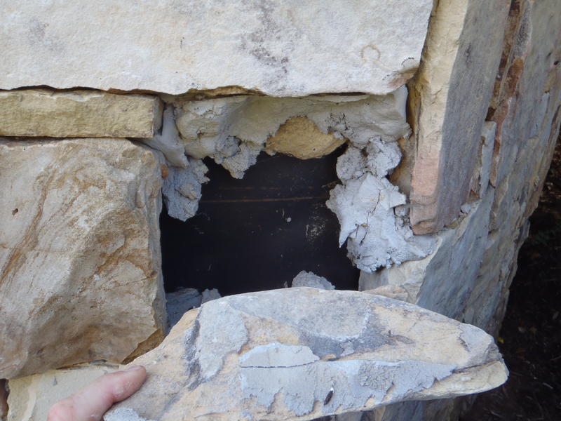

I dont get to see much real stone on homes, but this stuff looked all wrong to me.

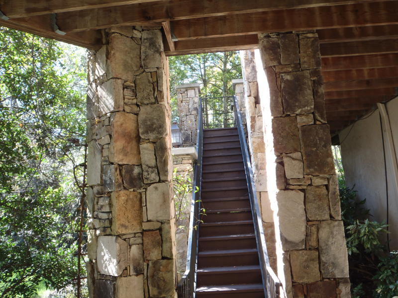

Stone was attached to substrate wood or block by metal tabs and mortared in. Suprisingly most was still attached, but many areas had loose stones. Multiple voids and holes, no expanded metal underneath.
The home was built in the 90’s
What is the proper attachement for this stuff. I would think just like any other masonry stucture. Also it was built around deck posts as well and did not have any metal lathe. Are there any potential concerns for covering presure treated posts?
Defective installation of a a Fabricated Stone Veneer (not real stone)…

Joe the stone was some type of cut rock, and not prefab. It was heavy enough to need metal tabs to secure it to the substate.

It is too thin for stone veneer
and a poor installation for a “Dry Stacked” installation…

Like I said, quite a different animal. Most was still attached, but everywhere you looked it was full of open gaps and holes.
Some stones were 6 inches thick. It does look like fake stone, but it was not.
It matters not the type of stone, it is installed like dry stack and it is going to leak if not already you need to be looking for interior moisture around the windows and even in the middle of the walls. I am envolved in 5 law suits with that same type of dry stack the builders just don’t do the house wrap properly how many layers of paper and or tyvec is behind the stone.

and clearly a defective installation of a dry stack veneer…
your first picture shows it…
Moisiture and damage already found my freind. My worry was its physical attachment to the home.
Sounds good to me. Defective it is.

This stone work was installed just the same as a brick veneer. The metal tabs were wall anchors sticking out of the stone work itself. They basically just blobed it all up the wall and used brick ties to hold it on.
So at this point I am going to consider it to be in line with brick veneer. Obviously if you looked at a brick wall and it was full of holes we would immediately say no.
I agree Sean. It is a poor installation of stone veneer.
