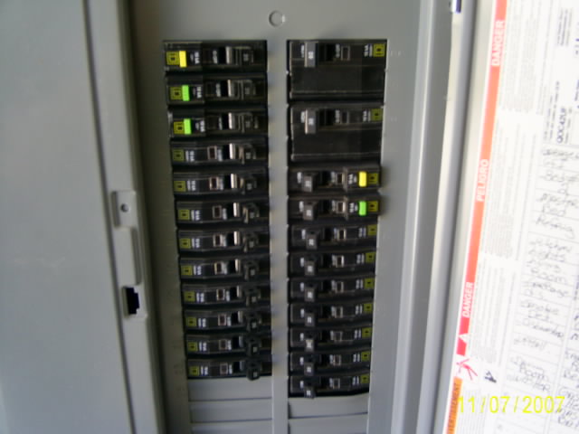

Exterior AFCI
Again, I see it everyday. New Construction 2900’ on crawl.
Separate breaker and 20 amp circuit, but not AFCI protected.
What matters is what the AHJ’s will enforce. I write 'em up, they shoot 'em down…:roll:
(breaker 15 - 5 or so from the bottom left - should be an AFCI, but ain’t)
-Mike

I would also add that if the hydronic wall heaters have 120 volt fans these need to be on the AFCI as well.
Mike,
There are areas that have exempted the AFCI requirements for smoke detectors. Some areas are even waiving the AFCI requirement for the bedroom outlets. Check with your local area to see what they are enforcing.
I know what they’re enforcing here… that they don’t have to be AFCI protected, hence the overkill in a prior post.
I think it’s a good idea, electrically sound and required by the NEC…
it’s just not enforced here, that’s my point. :neutral:
