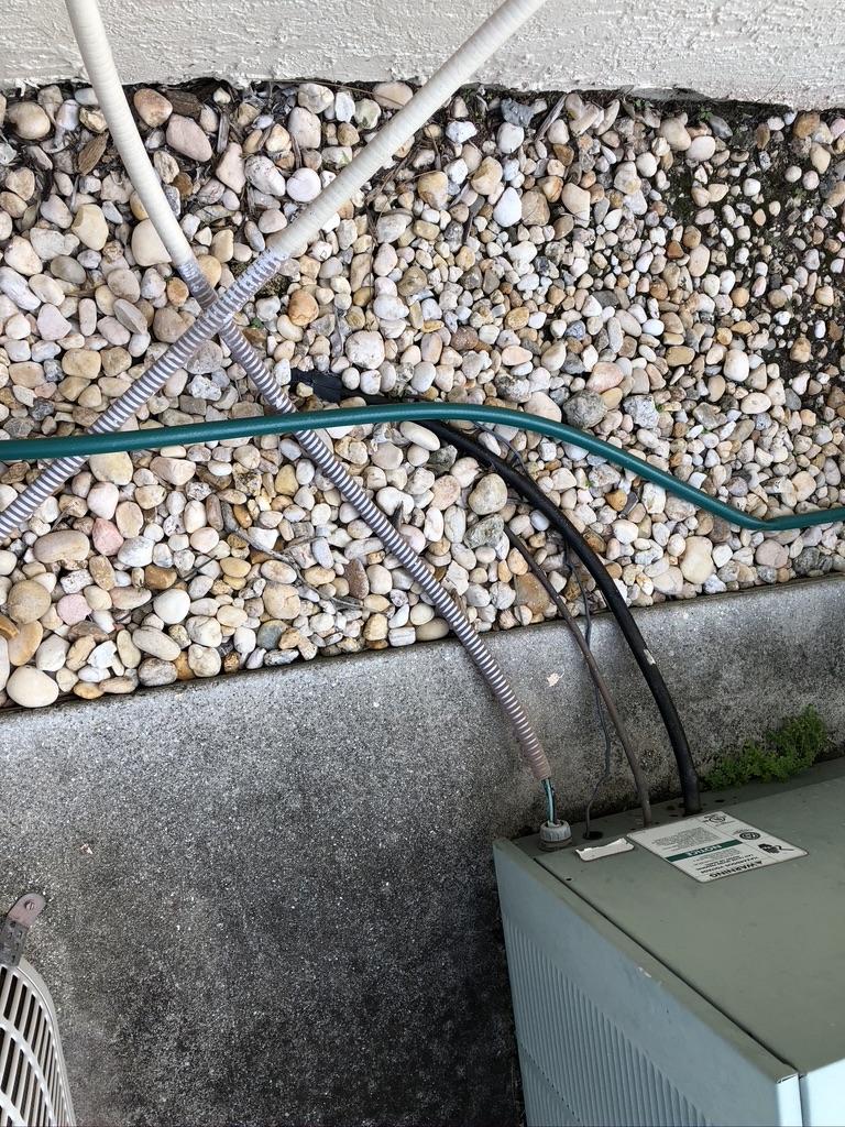

This view of the condensing unit shows two common HVAC deferred maintenance issues found during a home inspection:
The electrical conduit is damaged, exposing the electrical wires and creating an avenue for water and insect penetration of the compressor units electrical system.
The Insulation is missing from the suction line.
