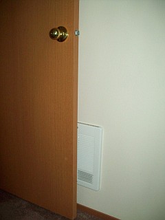

Inspected a house that had a fan assisted wall heater that was partly blocked with a wood door. What would be acceptable repairs besides moving the heater: Install a metal door? Install a bi-fold door? Install a door stop to keep the door away from the heater and what would be the safe distance?

I think he is concerned as to if it poses a fire hazard.
Most of those heaters are equipped with Thermal safety switches so if they overheat, they will shut off and have to re-set manually.

The Cadet Co. recommends 3’ clearance from the front of the heater.Keeping the door closed is not an answer and thermal switches are known to fail. I would not want to tell a client who’s house burned down, that they should of had the door closed.

Needs relocated or removal in my opinion. :slight_smile:
Exactly, it is a poor installation location.

A partially blocked fan forced heater (electric) will not function as manufactured, but doubt it would cause a fire like it’s relative, the electric radiant heater. :slight_smile:
Door is to close too heater vent, recommend evaluation by HVAC Contractor with remedy as necessary.
That is exactly what I would have noted in my report Brian,

Some of here are truly experts in many phases of Construction(Marcel specifically, me not so much). But as an Inspector it is not our job to design/advise/suggest how to fix/repair/correct anything. This will lead to trouble. ID the problem, suggest/recommend the appropriate trade/specialist to evaluated and repair/correct/as needed.
