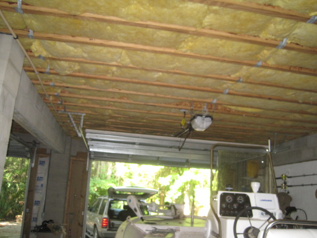

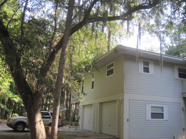

Did a 2 story stilted home. The garage on the bottom floor. Does the ceiling in the garage need to be fire rated?
Here’s some pictures.
I don’t see any stilts and is there living quarters above it?
If it does, it should have a 5/8" drywall, and moisture barier on the ceiling and minimum of 1/2" drywall and moistue barrier on the walls.

Thanks for the replies. The home was built in 2001 and the living quarters are above it.
Fire rated on a free standing single family-no.
Rock and moisture-yes
The code does not use the word “fire rated” when talking about a garage walls or ceilings and we should not either. The only time the phrase “fire rated” occurs in the IRC is when talking about the door separating the garage from the house, and the use of a fire-rated door is just one of several options that are allowed.
I use the word “fire barrier” in my narratives. The code actually says “fire resistant construction”. “Fire rated assemblies” are detailed in the IBC and are not part of the code for one and two-family dwellings (the IRC).
fyi: R302.6 Dwelling/garage fire separation.

“R309.2 Separation Required
The garage shall be separated from the residence and its attic area by not less than ½-inch (12.7 mm) gypsum board applied to the garage side. Garages beneath habitable rooms shall be separated from all habitable rooms above by not less than 5/8-inch (15.9 mm) Type X gypsum board or equivalent.”
Does the garage requite Type X - fire resistant sheetrock or is regular interior sheetrock permissible?

Standard 1/2" on walls and ceiling with attic above.
Very good Michael. That is correct.
YES. but the garage might not be considered “Fire Rated” even though it has type X board. It will have a period of protection to the dwelling areas inside the residence, but not rated per UL design classifications.
